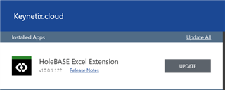

When the Keynetix.cloud launcher is run the update icon will appear:
Select this button to begin the launcher installation.  Note this must be done before any of the applications can be run.
