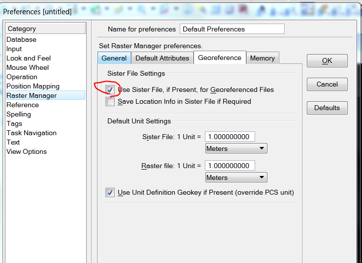

Sister file is not being used to attach Mr Sid file
Change User Preferences to Use Sister File and restart MicroStation
