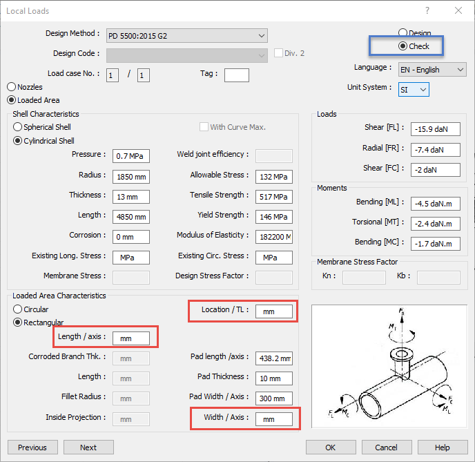

"Bentley AutoPIPE Vessel Design and Calculations has stopped working" message appears when running Strength Calculations on a Component Design model
Why and how to avoid it?
Reason #1: Confirm all data required by program has been specified:
Example:

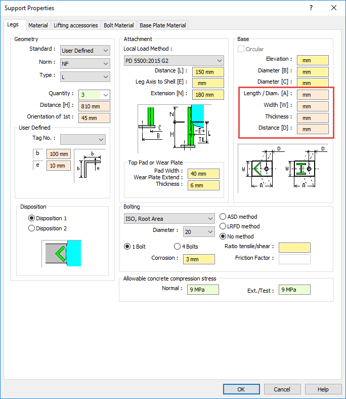

The model is in check mode, all data must be filled. Especially when this is a component design, see the missing data leading to the crash:
Example:
Missing mandatory data of the base plate.
