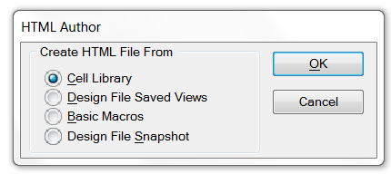

Instructions:
1. Menu Utilities\HTML Author-> select Cell Library->ok

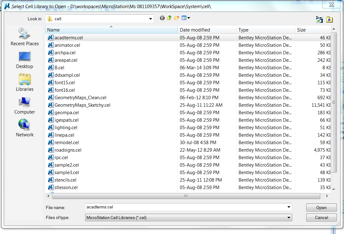

2. Select Cell library-> Open

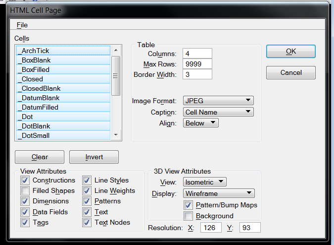

3. The dialog opens (select your required settings) -> Accept

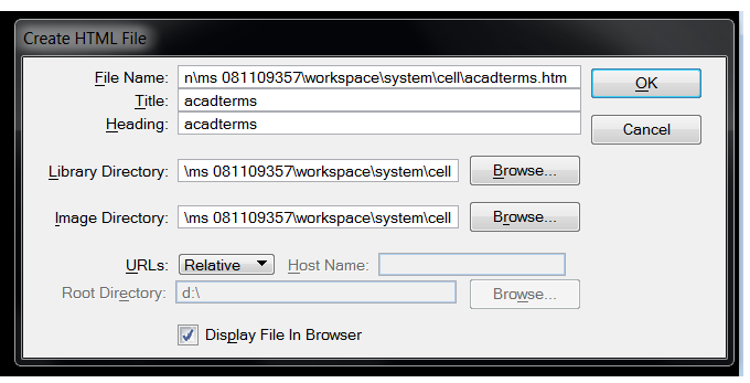

4. Create HTML file opens (you can modify library directory or image directory)-> Accept

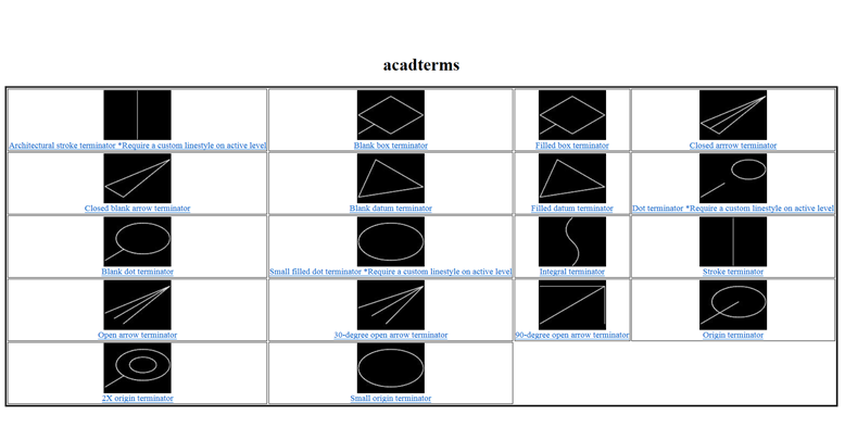

If you turn on Display File in Browser you will be able of previewing the results.
Note: Example: in my case the directory where acadterm.html was created was D:\workspaces\MicroStation\MS 081109459\Workspace\System\cell\acadterm.html
