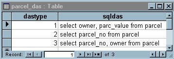

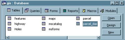

First, you need to create a Displayable Attributes table in your database. This table may be given any SQL-compliant name. Typically the name of the attribute table is included. In this case, we will create displayable attributes for the parcel table, so we will name the table parcel_das (see Figure 1). This table defines the relationship between the unique ID used by the tool, the attribute table to be used and the SQL statements used to retrieve your attributes.
In this table you will need two columns. The first column in this table is one that will be populated with integers, titled "dastype." This column stores the unique ID value used to identify which SQL statement will be run when using the Displayable Attributes tool.
Figure 2
Second, you need to create an "sqldas" column. In this column, you will create a SQL statement that defines the attributes you wish to retrieve and display. (Example: If you wish to display the owner name and parcel value, the following select statement would be Select owner, parcel_value from parcel(See Figure 2).

The next step is to create a relationship between the Database Attribute table and the DAS table. This is done by locating the table in the mscatalog and entering the name of the DAS table in the dastable column of the mscatalog. In this case, enter parcel_das into the dastable column for the parcel table (see Figure 3).
