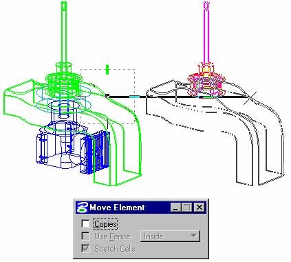

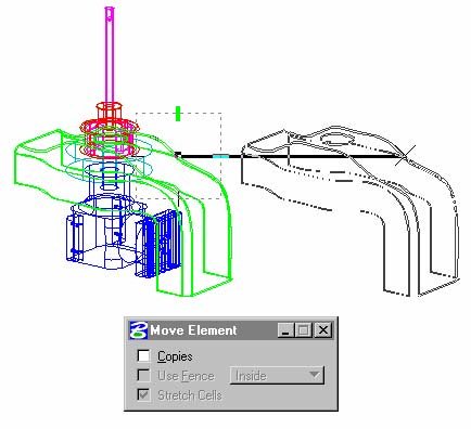

When a group is selected from the Named Group dialog window by double clicking or selecting the Select Elements in Named Group button, all of the elements that are included in the group are highlighted and can be manipulated as one entity. For example, Figure 2 shows that all of the members of the named group called Engine Assembly move as one entity, and all their elements will move as one, as long as the Graphic Group Lock is toggled on.
Figure 2: The Move Element tool shows how four separate items within one named group can move together. Here, the Engine Assembly named group moves as one, although it contains four different elements.

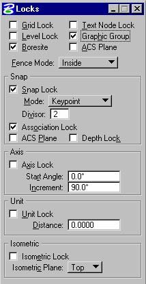

In order to manipulate or move one particular element within a named group, the Graphic Group lock needs to be toggled off. Do this by going to the Lock icon at the bottom of the window of MicroStation and checking the Graphic Group, or by going to the Settings pull down menu and then selecting Locks

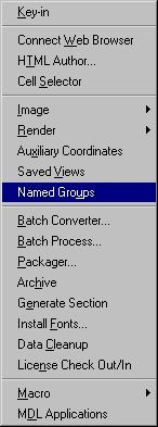

Where is the Named Groups tool located?
The Named Groups tools are located under the Utilities pull down menu (See Figure 4), or you can select the magnifying glass on the Add To Graphic Group tool. By selecting the magnifying glass, the Named Groups dialog window will open.

Keep in mind that if Graphic Group is toggled on under the locks settings, the entire Named Group will be dropped. Therefore, to drop one element out of a group, toggle off Graphic Group before performing this operation.

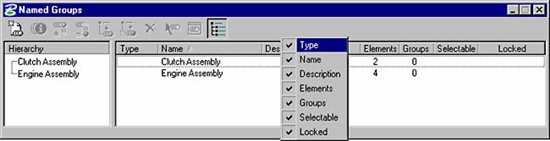

Figure 11: The column tools Fly-out menu appears when a right click is performed while the cursor is placed over the column areas in the Named Groups window.
Displaying the columns in the Named Groups Window
When viewing the Named Groups window, you will notice different columns displaying information about the named group, for example, the number of elements contained in the group and the group number. All of the columns can be toggled on and off easily by hovering the cursor over the column name and right clicking (Reset button by default), then toggling which column you want to display.

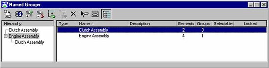

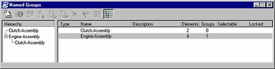

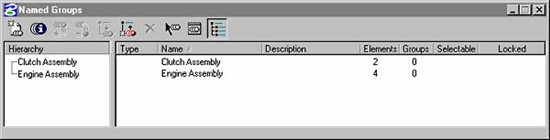

Figure 13: Named Groups dialog window with the Show Hierarchy toggled on.
Figure 14: Named Groups dialog window with the Show Hierarchy toggled off.
The Show Hierarchy icon allows you to see the additional Named Groups that may be under a Parent Group. A plus sign indicates hierarchical groups under the Parent Group and lets you expand the Named Group tree. The Show Hierarchy icon toggles the Named Groups dialog window.

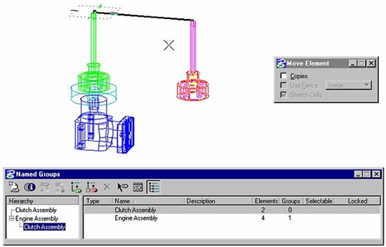

Figure 15: The Clutch Assembly named group is below the Engine Assembly Group. When selected, only the two elements associated with the Clutch Assembly Group can be manipulated using the Move Element tool.
Figure 16: The Named Groups dialog window showing that the Clutch Assembly Named Group has been added as a child named group below the Engine Assembly named group.
This particular feature is especially useful when you want to combine two or more named groups together and still see what is in each individual Named Group. By using this hierarchical Named Group structure, large quantities of elements can be selected at once for a move or small number of groups can be selected as well making this feature very flexible when group elements together. In Figure 15, the Clutch Assembly is a child named group underneath the Parent Group called Engine Assembly. By selecting the Clutch Assembly, on the two elements associated with that named group can be manipulated.

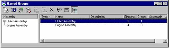

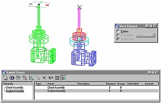

Figure 17: The Named Groups dialog window showing the Clutch Assembly removed from the Parent Engine Assembly Named Group.
The Remove Group from Parent tool works in the opposite way that the Add Group to Parent tool works. The Remove Group from Parent tool allows you to remove a Named Group from a Parent Group. In order to utilize this tool, select the Named Child Group under the Parent Group from the tree. Next, select the Remove Group from Parent and the named group will be removed.
