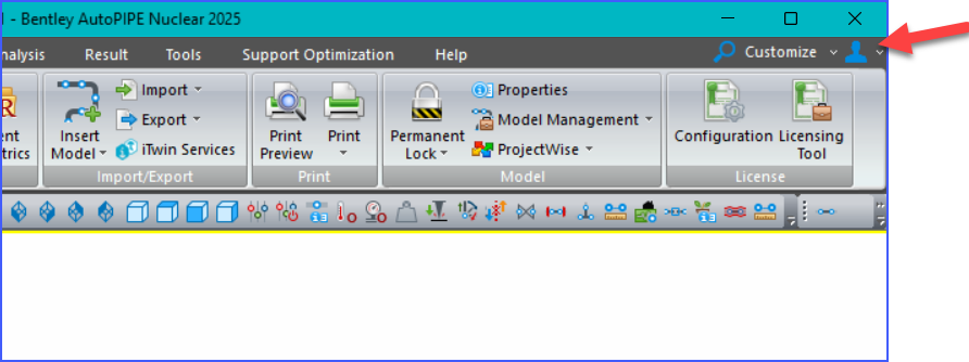

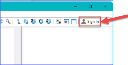

Option #1: From Within AutoPIPE or AutoPIPE Vessel

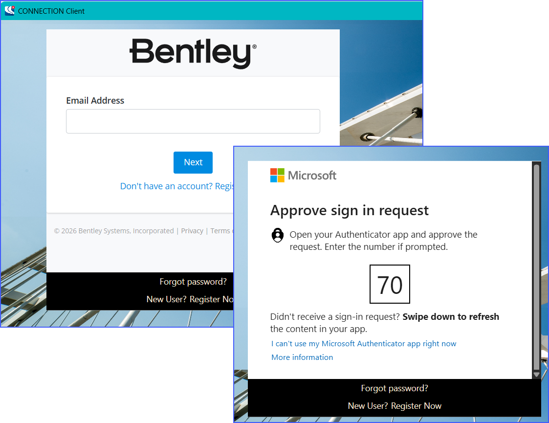

1. Start AutoPIPE or AutoPIPE Vessel, select "Sign In"
2. Sign into CONNECTION Client
From AutoPIPE:
From AutoPIPE Vessel:
Note: If you cannot log into Bentley CONNECTION Client, perform the following:
a. New Users sign up for an account by pressing the hyperlink to New User? Register Now.
b. Confirm User name and Password entered are correct. All Bentley websites use the same credentials to Sign In. Press Forgot Password? as needed.
c. Check that the company IT department has recently changed the security certificate that your systems uses to prove a computer is legitimate and safe to connect to with Connection Client.  Another words, your computer (or network) did not yet recognize or trust this new “root certificate”, so when trying to sign into Connection Client, it blocked the connection for security reasons. From the user’s point of view, this just looked like “I can’t log in.”  Confirm company did or did not push out the new certificate (either through an update, system policy, or IT deployment). Again if new root certificate was not updated the computer will not trust Bentley’s servers. Correctly install the new root certification. After that, Connection Client could securely connect, and login started working normally.
d. If the above fail, contact nearest Bentley office, and speak with an analyst about web related issues, including login and password
 1-800-BENTLEY (1-800-236-8539)
Outside the United States +1 610-458-5000
More local offices
Done, at this point you are Signed In.

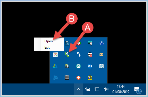

Option #2: From Window's Task-bar
1. From your task bar, find the following ICON
Notes:
a. Hovering over the icon will show "CONNECTION Client"
2. Click on the Icon and select OPEN option.
3. On the dialog, enter your Bentley credentials and follow the remaining on screen prompts
4. The dialog will then disappear if the information was accepted, otherwise a message would have appeared asking to enter a valid email address or password.

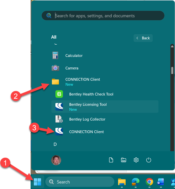

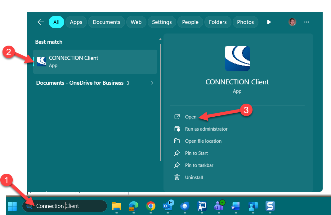

Option #3: From Window's Start Menu
1. Press the Window's Start button in the lower left corner of the screen, choose one method
a. Type "CONNECTION Client" into the search bar, and select "CONNECTION Client" from best match listing
or
b. Navigate to "CONNECTION Client" folder and select "CONNECTION Client" from listing
2. On the dialog, enter your Bentley email address registered with Bentley, press "Next" button, Enter your Password, press the Next button, and complete 2nd authentication process:
3. The dialog will then disappear if the information was accepted, otherwise a message would have appeared asking to enter valid information.
