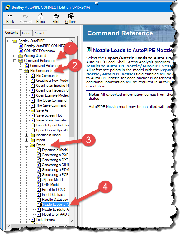

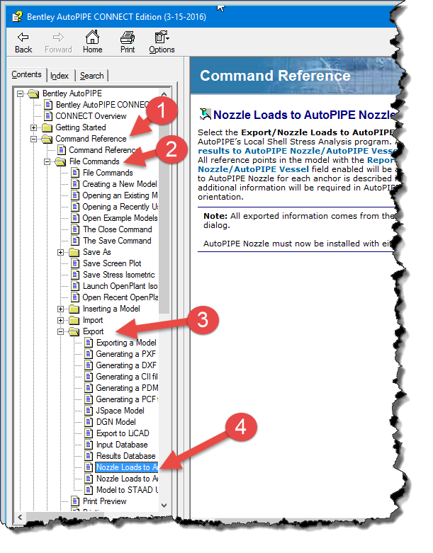

How to export loads from AutoPIPE to AutoPIPE Nozzle?
Please see the following AutoPIPE help section:
Help > Contents> Contents Tab> Bentley AutoPIPE> Command Reference> File Commands> Export> Nozzle Loads to AutoPIPE Nozzle
Use the following procedure:
Note: Before starting this procedure be sure to have  AutoPIPE (Advance or Nuclear) and AutoPIPE Nozzle correctly installed and licensed. AutoPIPE Nozzle cannot be licensed with AutoPIPE Standard.

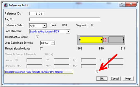

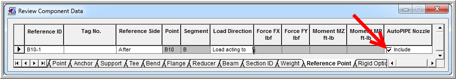

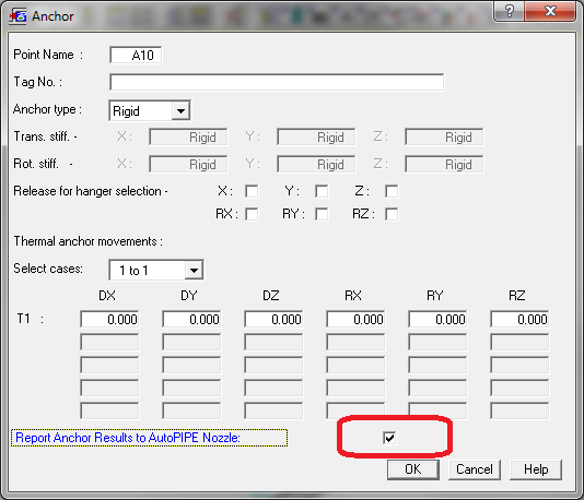

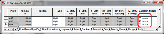

2. Methods of setting which anchors or reference points are to be exported to AutoPIPE Nozzle:
a. Grids:
i. Open the model's Input grids (Edit> Grids), select the Anchor tab, in the very last column on the right place a check mark in the box as shown below:
And / Or
ii. Open the model's Input grids (Edit> Grids), select the "Reference Point" tab, in the very last column on the right place a check mark in the box as shown below:
b. Anchor dialog:
i. On the Anchor dialog, place a check mark in the box "Report anchor results to AutoPIPE Nozzle"
And / Or
ii. On the Reference Point dialog, place a check mark in the box "Report reference Point results to AutoPIPE Nozzle"
