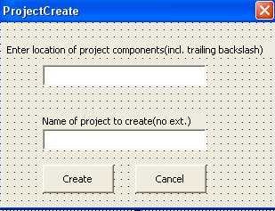

The first step is to design a UserForm so that the end-user will be able to enter this information:
Image of UserForm
First, right-click the Project in the Project dialog box and select Insert > UserForm. You can rename the UserForm in the Properties dialog of the UserForm and name it ProjectCreate (or whatever name you like). Then add two textboxes and two pushbuttons. You can also add two labels above the textboxes explaining what you expect the end-user to use them for input. The next step is to select one of the pushbuttons and rename it "Create," then select the other one and name it "Cancel." After these steps, your UserForm should be finished.
