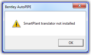

"SmartPlant translator not installed".. message appears when trying to open a PCF file in AutoPIPE,
OK
why?
There are 2 reasons why this message will appear:

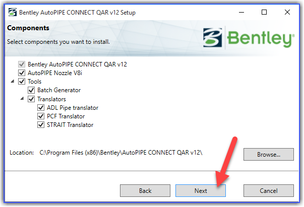

Reason #1:  PCF translator is not installed
As mentioned on the dialog, the PCF translator has not been installed. During the installation of AutoPIPE, the user was given the opportunity to install other applications that run independently of AutoPIPE.These are checked on by default. The person or script used to install AutoPIPE physically unchecked some or all of these options.
Typical dialog shown here:
After make the selection choices, continue installing AutoPIPE by pressing Next button.
If a user tries to initiate a command in AutoPIPE that would interface with these independent applications, a message like that above would be displayed.
Workaround:
Uninstall AutoPIPE Setup from the computer, and reinstall the program with default settings (see here)

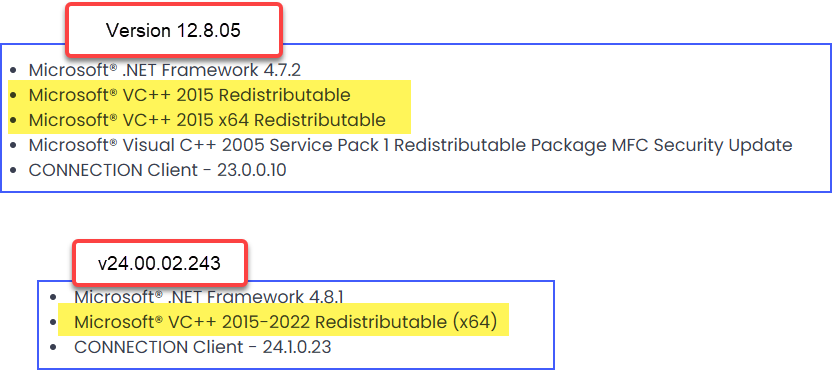

If yes, the error code 0xe06d7363 typically occurs when your system lacks some crucial redistributable packages like Visual C++ extensions. And this appears only when you try to start a process or an operation that requires Visual C++ to be running on your PC.
Recall from above, one can installing multiple versions of AutoPIPE on the same but there is only one version of the translators. Note, from AutoPIPE's readme files, files installed:
Therefore, when using the Import> SmartPlant Translator command in AutoPIPE 12.8, the program is using Microsoft® VC++ 2015-2022 Redistributable (x64) protocol because of AutoPIPE 24's installation updating the files, when it should be using  Microsoft® VC++ 2015 Redistributable protocol, as was originally installed by AutoPIPE's 12.08 installer.
