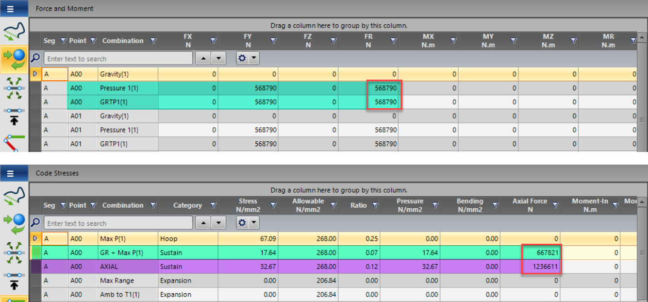

Scenario #3:
Problem Description:
Why does AutoPIPE report different axial force values in the following output reports?
The model uses the following conditions:
Explanation:
The values are different because the two reports represent different physical quantities.
Two longitudinal pressure-related forces must be considered:
    1. Pressure end force, caused by internal pressure acting over the internal cross-sectional area of the pipe.
    2. Pressure extension restraint force, required at the anchor to prevent the pipe from extending longitudinally.
The Anchor report and Forces & Moments report displays the force required to restrain the longitudinal pressure extension.
The Code Stresses report uses the net longitudinal pressure force for code-stress post-processing.
The following calculations are based on the values provided in attached excel sheet.
1. Input Data
The example uses the following pipe and pressure properties:
Property Symbol Value
Pipe outside diameter OD 1016 mm
Pipe wall thickness t 12 mm
Pipe inside diameter ID 992 mm
Pipe length L 100,000 mm
Cold modulus of elasticity Ec 207,000 N/mm²
Poisson’s ratio ν 0.27
Design internal pressure p 1.6 N/mm²
2. Calculate the Internal Pipe Area
3. Calculate the Pipe Metal Cross-Sectional Area
This area is used when calculating axial strain, extension, restraint force, and longitudinal stress in the pipe wall.
4. Calculate the Pressure End Force
This represents the total longitudinal force generated by internal pressure acting on the pipe’s internal cross-sectional area.
This value can be verified in AutoPIPE by creating a User Combination that includes only the applicable longitudinal pressure load.
Define the "Long" at Stress Level and set the Category to Sustained. When the Code Stress results for this combination are reviewed, the reported axial force corresponds to the end-cap force generated by internal pressure.
As shown in screenshot below:
5. Calculate the Free Longitudinal Pressure Extension
This is the longitudinal extension associated with the pressure end force before accounting for the circumferential expansion and Poisson’s effect.
6. Calculate the Longitudinal Contraction Due to Poisson’s Effect
This value represents the longitudinal contraction associated with Poisson’s effect from the pressure-induced circumferential strain.
7. Calculate the Net Pressure Extension
Therefore, if the pipe were free to move, the pressure loading would produce a net longitudinal extension of approximately 7.26 mm.
8. Calculate the Force Required to Prevent Pressure Extension
This is the axial force displayed in the Anchor report and Forces & Moments report for the pressure load case. It represents the restraint force required at the anchor to prevent the pipe from undergoing longitudinal pressure extension.
The small difference between the manual value and the AutoPIPE result can occur because the manual calculation uses rounded input and displayed values, while AutoPIPE performs the analysis using the model’s internal precision and detailed section properties.
9. Calculate the Net Axial Force Used in Code Stresses
This value is displayed in the Code Stresses report as the axial force.
Therefore:
The manual calculation confirms that the reported values are consistent, allowing for rounding and the internal precision used by AutoPIPE.
10. Calculate the Stress Due to Restrained Pressure Extension
This is the axial stress produced by restraining the pipe’s pressure-induced longitudinal extension.
11. Calculate the Longitudinal Pressure Stress
This represents the longitudinal pressure stress before subtracting the stress associated with the restrained pressure extension.
12. Calculate the Net Pressure Stress
This confirms that AutoPIPE uses the net longitudinal pressure effect for code-stress post-processing.
13. Summary of Results
Calculated quantity Manual result AutoPIPE result/report
Pressure end force 1,236,611 N Approximately 1,236,611 N in pressure-related code output
Pressure extension 15.7833 mm Intermediate calculation
Poisson-related contraction 8.5230 mm Intermediate calculation
Net pressure extension 7.2603 mm Intermediate calculation
Force required to prevent extension 568,841 N Approximately 568,790 N in Anchor and Forces & Moments report
Net axial force 667,770 N Approximately 667,821 N in Code Stresses
Stress due to restrained extension 15.0289 N/mm² Intermediate stress component
Longitudinal pressure stress 32.6714 N/mm² Pressure end-force stress
Net pressure stress 17.6426 N/mm² Approximately 17.64 N/mm² in Code Stresses
The manual-calculation results and the corresponding AutoPIPE output values are provided in attached excel sheet.
Conclusion:
The axial force in Anchor and Forces & Moments should not be expected to match the axial force in Code Stresses because the reports represent different pressure-related quantities.
The Anchor Forces & Moments value of approximately 568,790 N represents the force required at the anchor to prevent the pipe from extending under internal pressure.
The Code Stresses value of approximately 667,821 N represents the net longitudinal pressure force used during code-stress post-processing.
Minor differences between the manual calculations and the reported AutoPIPE values are expected due to rounded displayed inputs and the higher numerical precision used internally by AutoPIPE.
