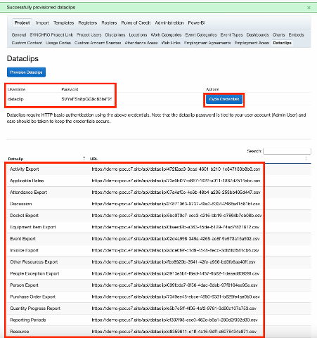

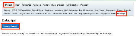

To provision these dataclips for your project, you are required to have a user permission role of project_config:
Under Settings > Go To Project > Dataclips > Provision Dataclips
Each individual user can generate their own credentials for dataclips
Use the Username and Password provided for your account in any application you wish to utilise the dataclip for
Currently the following dataclips are available for self-service provisioning:
| Dataclip | Description |
| Activity Export | Similar to the export within the web UI |
| Applicable Rates | Used to review rates that are currently being applied to a resource |
| Attendance Export | Similar to the export within the web UI |
| Discussion | Used for reporting timeline entries recorded against activities |
| Docket Export | Similar to the export within the Web UI |
| Equipment Item Export | Similar to the export within the Web UI |
| Event Export | Similar to the export within the Web UI |
| Invoice Export | Similar to the export within the Web UI |
| Other Resources Export | Similar to the export within the Web UI |
| People Exception Export | Similar to the export within the Web UI |
| Person Export | Similar to the export within the Web UI |
| Purchase Order Export | Similar to the export within the Web UI |
| Quantity Progress Report | Similar to the export within the Web UI |
| Reporting Periods | Used to review the intervals of reporting and the calculation engine for Earned Value |
| Resource | Used to access resources currently on a project with the Resource UUIDs for the API |
| Resource Exception Report | Similar to the export within the Web UI |
| Resource Usage Export | Similar to the export within the Web UI |
| Resource Usage Export (Last 10 Days) | Similar to the export within the Web UI. A live dataclip restricted to the last 10 days. |
| Resource Usage Export (Last 20 Days) | Similar to the export within the Web UI. A live dataclip restricted to the last 20 days. |
| Resource Usage Export (Last 60 Days) | Similar to the export within the Web UI. A live dataclip restricted to the last 60 days. |
| Snapshot Export | Similar to the export within the Web UI |
| Supervision Roster Export | Similar to the export within the Web UI |
| Tagged Item Attributes | Used to report attributes against the available tagged items on a project |
| Tagged Item Completions | Used to report date of completions against available tagged items on a project |
| Tagged Item Registers Export | Similar to the export within the Web UI |
| WBS Export | Similar to the export within the Web UI |
| Work Roster Export | Similar to the export within the Web UI |

Depending on the size of the dataclip, you may receive an initial error "dataclip stale." This is likely due to the dataclip being accessed for the first time, or going dormant after a long period of no use. Calling the dataclip will trigger a new refresh/download that will eventually correct any stale dataclip errors initially encountered. On projects with large data volumes, the self-service dataclips may not always be successful. If you require additional dataclips, or any of the existing or not working, then please submit a service request with the following information.
