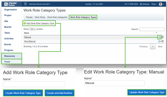

Add and Edit Work Role Category Types
Work Role Category Types can be added or edited at any time. They can only be deleted if they have no associated Work Role Categories.
  1. Click on Resources > People > Work Role Category Types.
  2. To add a new Work Role Category, click   Add Work Role Category Type, enter a name, then click either Create Work Role Category Type or Create and Add Another.
  3. To edit an existing Work Role Category Type, click on the   icon.
  4. Edit the name, then click Update Work Role Category to save changes.
  5. To delete a Work Role Category, click on the   icon.
    If a Work Role Category Type has a   icon, there is still data associated with this category and it cannot be deleted.
    In this case, edit all Work Roles Categories associated with this category to remove them, then delete the Work Role Category Type. (see next section)

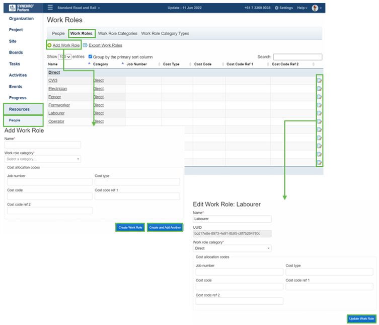

Add and Edit Work Roles
Work Roles are assigned to People to identify their role on the project. Work Roles form the basis of a hierarchy of Work Role Category and Work Role Category Type.
  1. Click on Resources > People > Work Roles.
  2. To add a new work role, click on   Add Work Role, enter details as needed, then click on either
    Create Work Role or Create and Add Another.
  3. Cost selector values entered against the Work Role here will supersede the Resource Usage Work References cost selector values*.
  4. Work Roles need not align with HR job titles, and can instead be a generic description of the role.
  5. To edit a Work Role, click on the   icon.
  6. Edit details as needed in the window that opens, then click Update Work Role to save changes.
Refer to the Cost Codes Allocation Rules article for more information.
