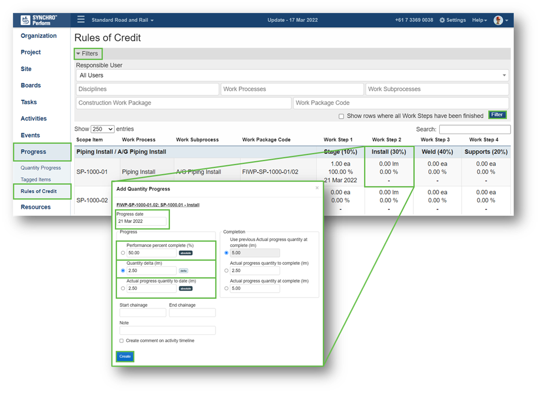

  1. Click on Progress > Rules of Credit
  2. Filter as required
  3. Click on the cell of the Scope Item and Work Step to be progressed
  4. In the pop-out screen, check or change the Progress date
  5. Enter values in either
    • Performance percent complete (%)
    • Quantity delta (UoM)
    • Actual progress quantity to date (UoM)
  6. Optionally, enter Start and End Chainage values, a Note and click the Create comment on activity timeline
  7. Click Create
