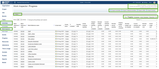

Work Inspector
The Work Inspector provides a view to manage the Activities.
  1. Click on Activities > Work Inspector.
    Activities can be managed from this view using Filters. Activities can be started, finished and paused or progressed from this view*.
  2. Activity data can be exported to an Excel file.
  3. Click Export Activities   to export all Activities data.
  4. Click Export Filtered Activities   to export a filtered set of Activities data.
  5. Click Export WBS   to export the WBS data.
  6. Click Export Events   to export the associated Event data.
    Details of last update, import and export are displayed in the top right-hand corner for reference.
  7. Different Views of the Activity data columns are displayed by clicking Progress, Schedule*, Work
    Packages, Reporting, or All.
  8. To view or edit an Activity’s details click on the Activity Work Reference Name.
* Refer to Quantity Progress Capture , Work Inspector Schedule, Activity Data Fields and Activities Import guides for further details
