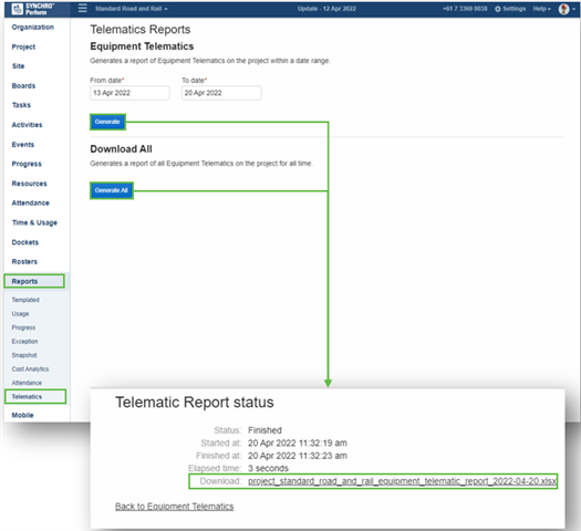

Telematics Reports and Exports
Telematics data can be exported to support integration with planning and reporting systems.
  1. To generate a report, click Reports > Telematics.
  2. Select the Date Range for the telematics export.
  3. Click Generate to create the report.
  4. Click Generate All to create a report of all telematics data for the life of the project.
  5. Click on the Download link that appears to download the report*.

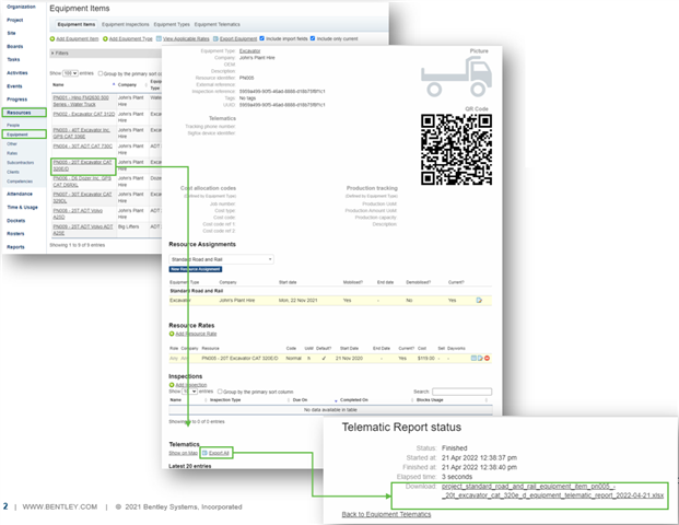

Telematics Reports - Equipment Item
  1. To generate a report for an individual equipment item, click Resources > Equipment.
  2. Select the equipment item link to view its data.
  3. In the Telematics section, click Export All.
  4. Click on the Download link that appears to download the report*.
* Refer to Telematics Export File Formats for further information on file.
