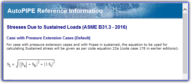

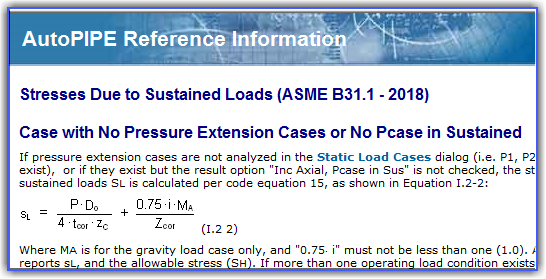

Would code stress results be the same regardless of which piping code was used in AutoPIPE?
Not necessarily, the results could be different because each code and year to year may have a different equation to calculate code stresses.
Example: See how the Sustain stress is calculated for ASME B31.3 and ASME B31.1
Again, results may not be the same when changing between codes or year to year.
