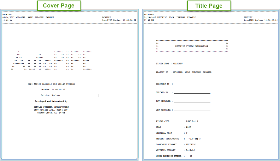

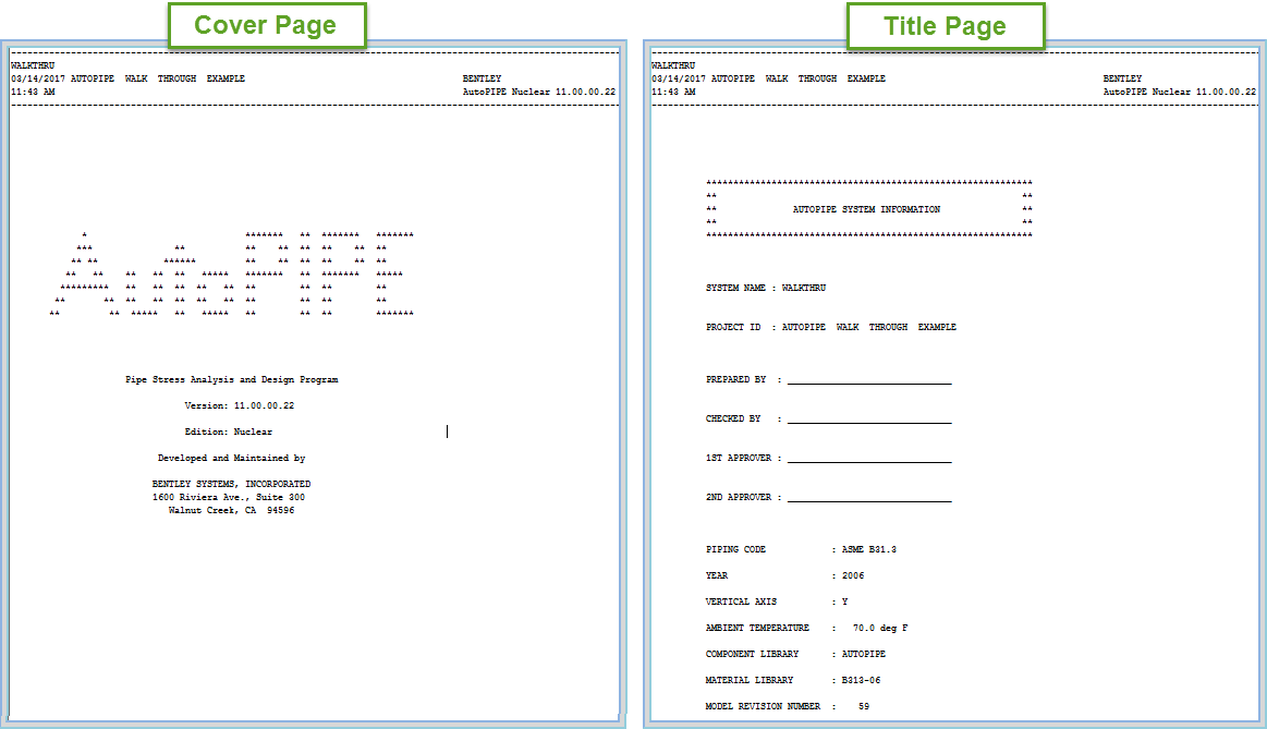

_AutoPIPE's Output report Cover and Title page
Cover page:
  • Name of Program
  • Version (ex. 6.03 and higher)
  • Edition (ex, Standard, Advanced, Nuclear)
  • Developer Name and Address
Title page:
  • Model Name
  • Project ID
  • Prepared By
  • Checked By
  • 1st Approver
  • 2nd Approver
  • Piping code
  • Year or piping code
  • Vertical Axis
  • Ambient Temperature
  • Component Library
  • Material Library
  • Model Revision Number
