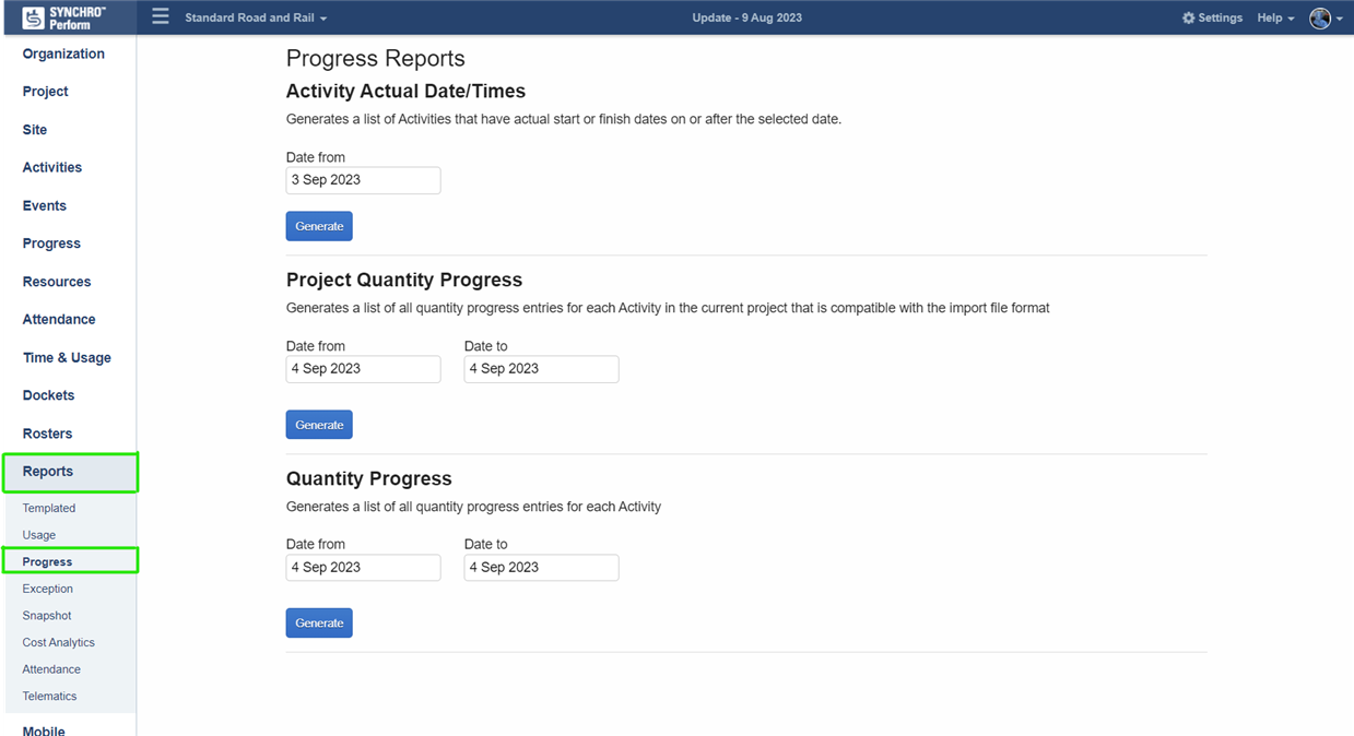

Progress data can be exported in a variety of data formats to support integration with planning and
reporting systems.
- The Activity Actual Date/Times report exports start and finish dates, and times, in a format suitable for update into planning systems. The Activities are filtered to those with actual start and finish dates on, or after, the selected From date.
- The Project Quantity Progress report lists existing progress quantity entries, and allows Users to edit and make bulk changes, so the file can then reupload to SYNCHRO Perform to update a large amount of data at once.
- The Quantity Progress report lists all quantity progress entries for a given activity, with details of baseline budgets, current progress and remaining quantity values for each entry, to verify progress.
Generate Report
- To generate a report, click Reports > Progress.
- Select the Date Range for the required report.
- Click on Generate under the required option to create the relevant report.
- Click on the Download link that appears to download the report*.
