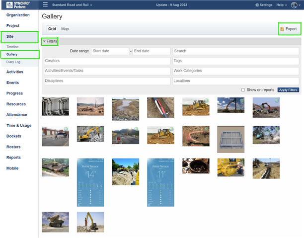

The Gallery displays all images captured on a project in SYNCHRO Perform, as well as their GPS location (where applicable), providing insight into on-site progress, and an overview of where work has been undertaken.
  1. Select Site > Gallery.
  2. Click on Filters to select and apply a filter.
  3. Click on an image to expand that image.
  4. Click on the   icon to view an image’s location in Google Maps.
  5. When expanded, click on the   icon in the top-right corner to view a thumbnail list of all images.
  6. Click on Export > Download to download images.

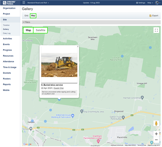

Gallery Map
  1. Alternatively, to view the Gallery Map, click on Map in the top-left corner.
  2. Each image is represented on the map with a blue marker.
  3. Click on a marker to see its information.
  4. Click Map or Satellite to toggle between map or satellite views.
