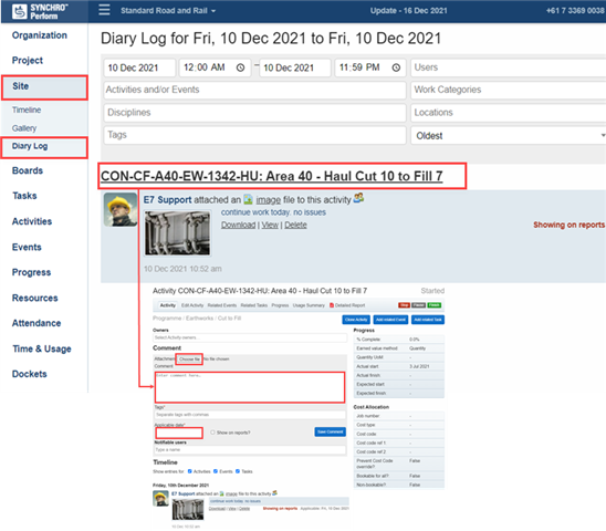

Users can track a project’s day-to-day on-site developments via Diary entries. The Diary Log shows all Diary entries made to SYNCHRO Perform, and can filter by date, Users, and other attributes, and add comments and files.
  1. Click on Site > Diary Log.
  2. Select a date range by selecting a Start Date and Time, and End Date and Time (up to 7 days), then click Filter.
    The date range will filter by the Applicable Date of the entries; if an entry does not have an Applicable Date, it will filter by date created.
  3. Use the filter options to search specific attributes or Users, then click Filter.
    This can be used with the date range option.
  4. The log shows Diaries, Activities, and Events; click on an entry’s title to view its details.
  5. Click on Choose File or Comment to attach files or comments to the entry, then click Save Comment.
  6. Add an Applicable Date as needed.
