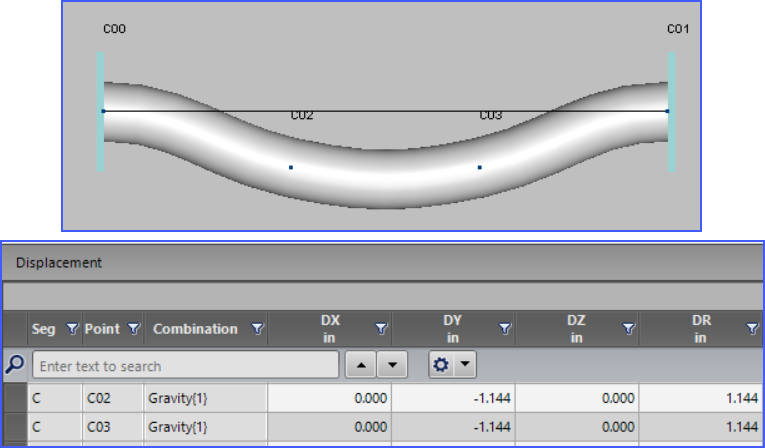

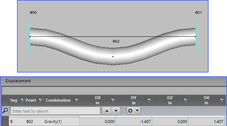

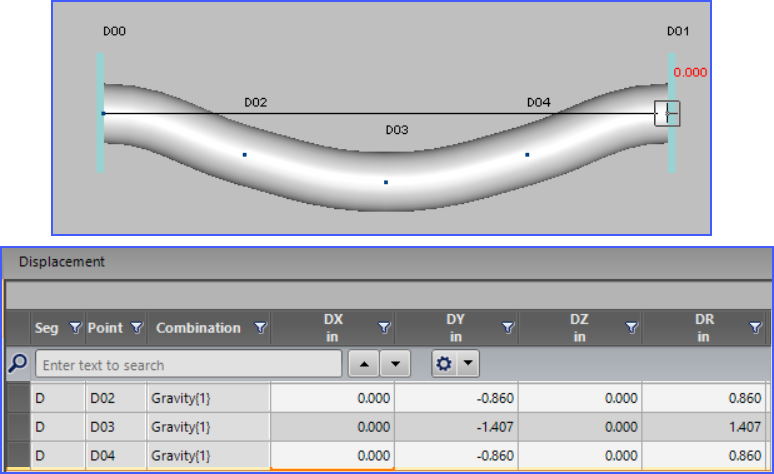

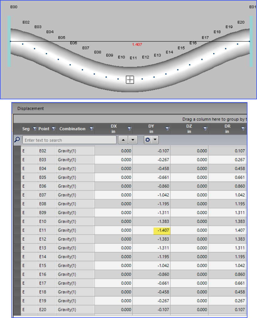

Example, pipe between 2 anchors:
Seg A has no node points between the anchors
Seg B has 1 node point between the anchors
Seg C has 2 node points between the anchors
Seg D has 3 node points between the anchors
Seg E has 19 node points between the anchors
Notes:
- Seg A does not have any displacement in between the anchor points. Recall from above, reason there was no node point for which the program to apply the load-case nor influence of pipe displacement beyond adjacent node points. '
- Seg E shape of the displaced curve is smoother as the number of node points increase, however the amount of accuracy is for maximum displacement is no better than when segment has 1 added node point.
Conclusion
When performing a:
- Static analysis, no results are generated for piping between node points.
- "Non-Code" combination deflected shape plots would be graphically approximated between node points based on applied loads at existing nodes and influences of piping displacement beyond adjacent node points.
- Adding more node points between existing unsupported nodes does increase the displacement accuracy of movement at a specific pipe location. However adding too many nodes into the model significantly increases analysis time without much gain in precision. Suggest to use an iterative approach of adding a few additional nodes between supports / existing node points, run a Static analysis, create an Displacement output report (Run1), add more node points into the model, again run a Static analysis, create an Displacement output report (Run 2) and compare the results. If significant difference, repeat iteration of adding more node points as needed until the difference was within an acceptable tolerance.
