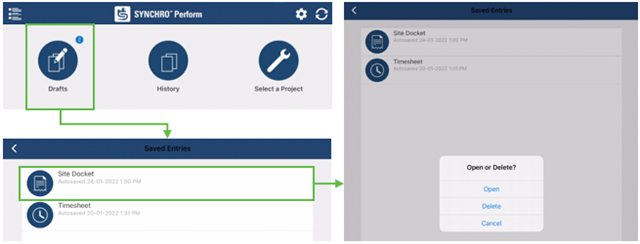

Entries captured in SYNCHRO Perform Mobile can be saved as Drafts and submitted at a later time. If an entry is left incomplete, it is saved as a draft, and is held in the Drafts function, where it can be edited and submitted.
View a Draft
  1. Select Drafts.
  2. Select an entry, then select:
    1. Open to edit and submit
    2. Delete to delete the entry
    3. Cancel to return to the Drafts screen

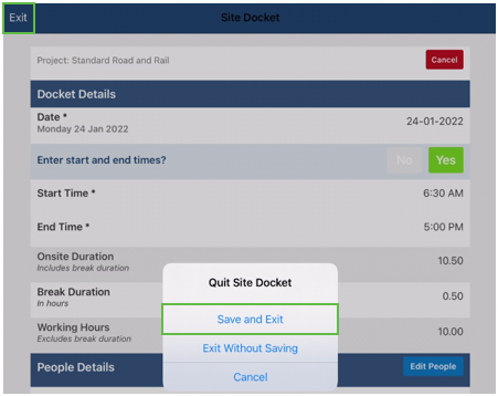

Create a Draft
  1. To create a Draft, select Exit while entering information into a page, then select Save and Exit.
    The information will be saved to the Drafts section.
  2. Select Exit Without Saving to delete the entry without saving a Draft.
