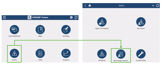

  1. Select Events > Bulk Assign Owners.

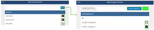

  2. Select names from the list of Owners, then select Next.
  3. Search for an Activity or Event, then select checkboxes from the list of options that appears.
  4. Select Add Activity/Event to add more items, or select Assign to assign the selected items to the Owners.
  5. Selecting Assign will also return the screen to the Events page.
