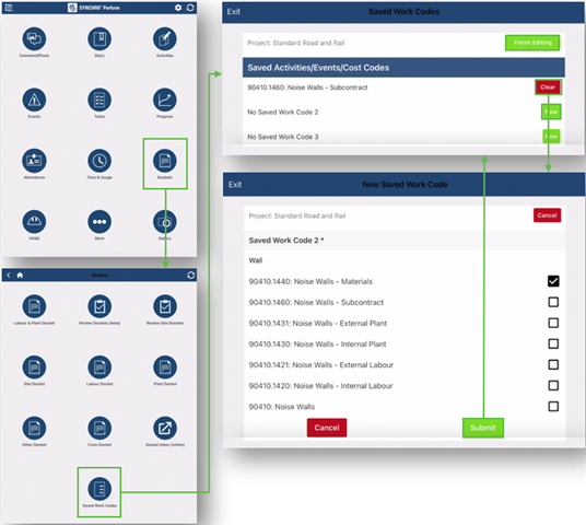

Preparing Saved Work Codes creates a list of Activities, Events, and Cost Codes for easy access when completing various forms in SYNCHRO Perform Mobile. Multiple codes can be saved for quick selection.
  1. Select Dockets > Saved Work Codes.
  2. To add a new Work Code, select New.
  3. To remove an existing code, select Clear.
  4. Search for a Work Code, select its check box, then select Submit.
  5. Repeat this process for additional Work Codes as needed.
  6. When all codes have been chosen, select Finish Editing.
