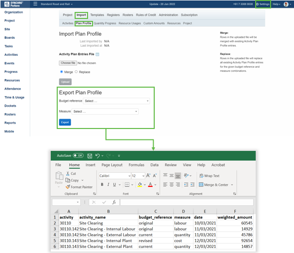

Export
  1. Click on Settings > Import > Plan Profile.
  2. Click on Export to generate a spreadsheet of existing data, then click the download link that  appears.
    • Budget Reference represents Original, Current or Revised.
    • Measure represents Labour, Quantity, or Cost.
    • This export can also be used as a template for importing data.

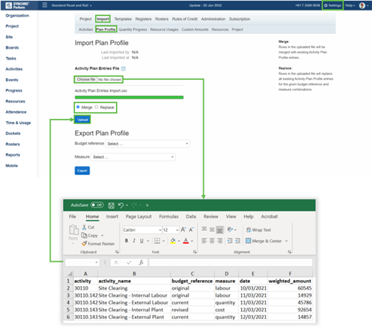

Import
  2. Click on Choose File, then select a file.
    The import file must include these columns: activity, activity_name, budget_reference, measure, date, and weighted_amount.
  3. Click either Merge or Replace.
    • Merge merges rows in the uploaded import file with existing Activity Plan Profile entries*
    • Replace replaces all existing Activity Plan Profile entries for a budget reference and measure combination
  4. When the file has loaded, click Upload.
