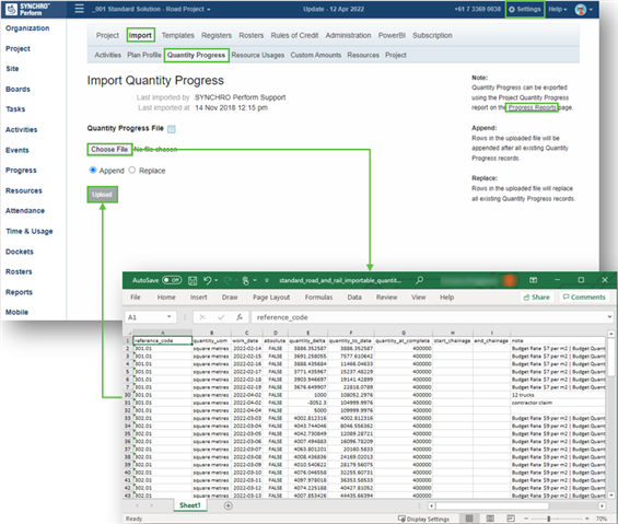

Quantity Progress Import
Quantity Progress entries can be imported in bulk as new entries or to correct existing entries.
  1. Click on Settings > Import > Quantity Progress.
  2. To create a file for import, click on Progress Reports to export a file*, then click on Choose File, then select the file for import.
  3. Click on the Quantity Progress File icon to show column mapping.
  4. Click either Append or Replace.
    • Append - rows in the uploaded import file will be appended after the existing Quantity Progress records.
    • Replace - rows in the uploaded import file will replace existing Quantity Progress records.
  5. When the file has loaded, click Upload.
