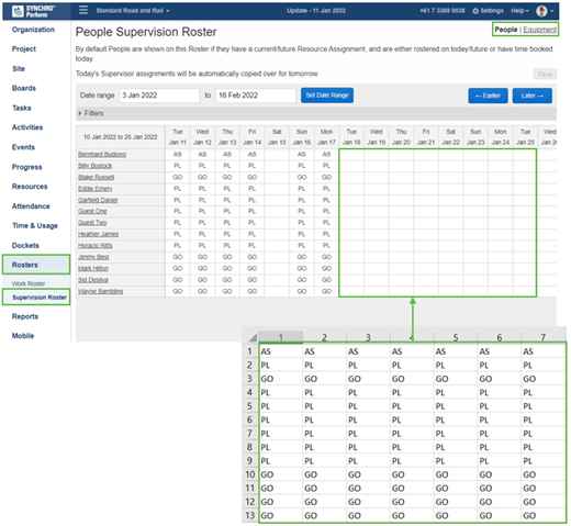

  1. Click on Rosters > Supervision Roster.

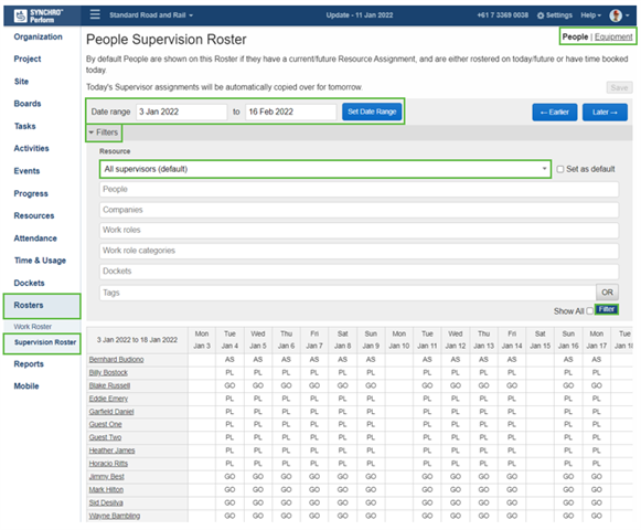

  2. Set a date range (no greater than 45 days), then click on Set Date Range.
  3. Click on People or Equipment in the top-right corner to switch between these options.
  4. Click on Filters, enter search terms, then click Filter to find People or Equipment as needed.
  5. Show only People or Equipment without a supervisor by selecting No Supervisor.
  6. Enter a supervisor’s initials or Supervisor Code for each Resource on the dates they supervise.
  7. Double-click a cell for a list of all supervisors.
  8. Once a cell is entered, click and drag to populate multiple cells at once as needed.
  9. The roster saves automatically.
    • Supervision Roster details can also be copied and pasted from an Excel spreadsheet. However, the Excel data must exactly match the SYNCHRO Perform data.
