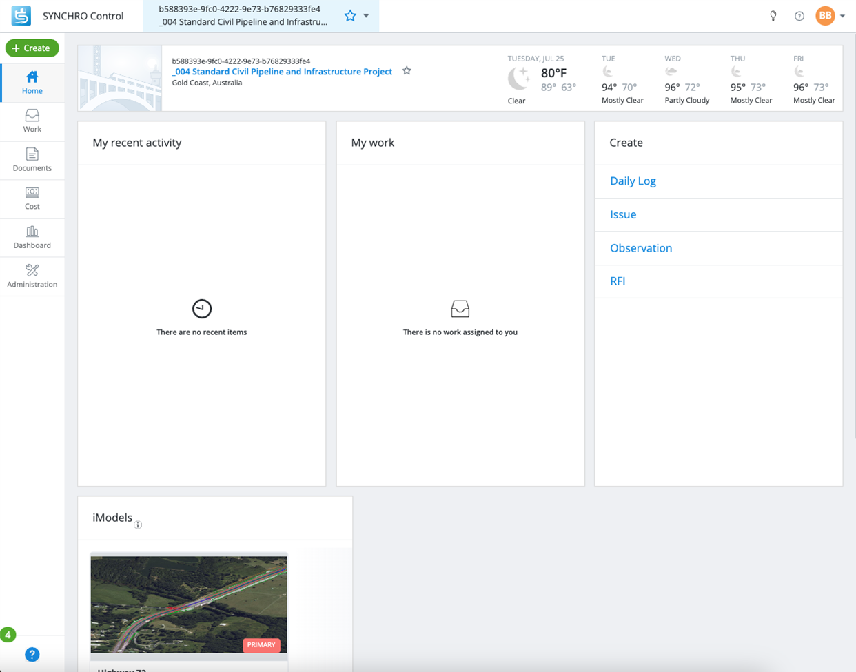

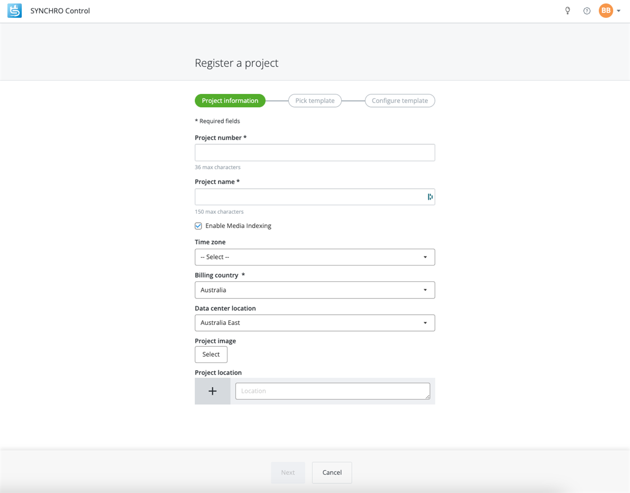

1) Login to SYNCHRO Control via https://construction.bentley.com, You should be able to see a "Register a project" button. Click this. If you cannot see Register a Project, then you will need to have your permissions elevated within Bentley. Please refer to your administrator for assistance; if you don't know who your administrator is, more information can be found here.
2) Fill out the details, including where you want project data to be stored.
3) Once complete, the project should be available for users to view and utilise all features within Control.
4) Ensure you are using IMS/Bentley SSO to link projects, making sure you select the project you want to link between Perform and Control.

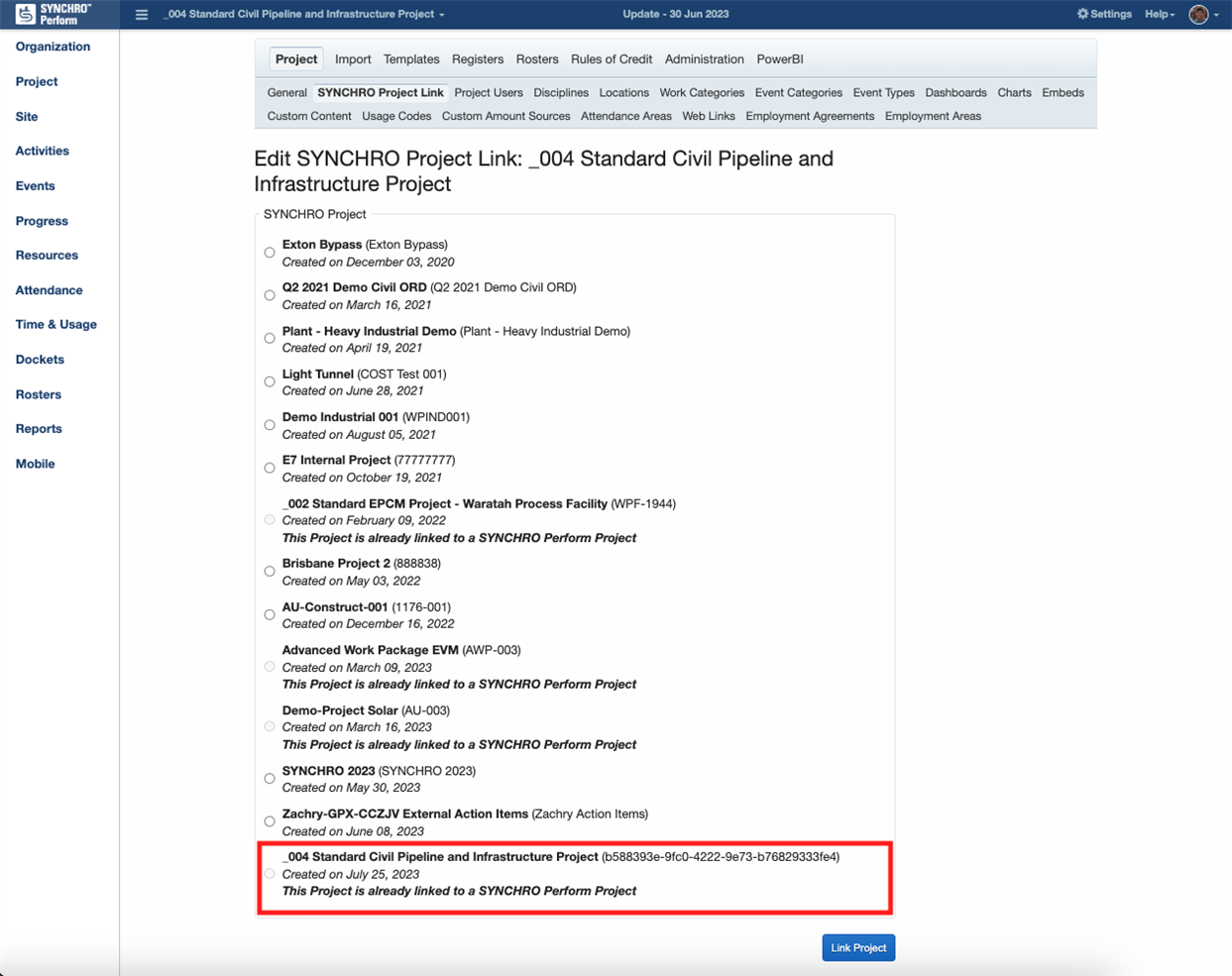

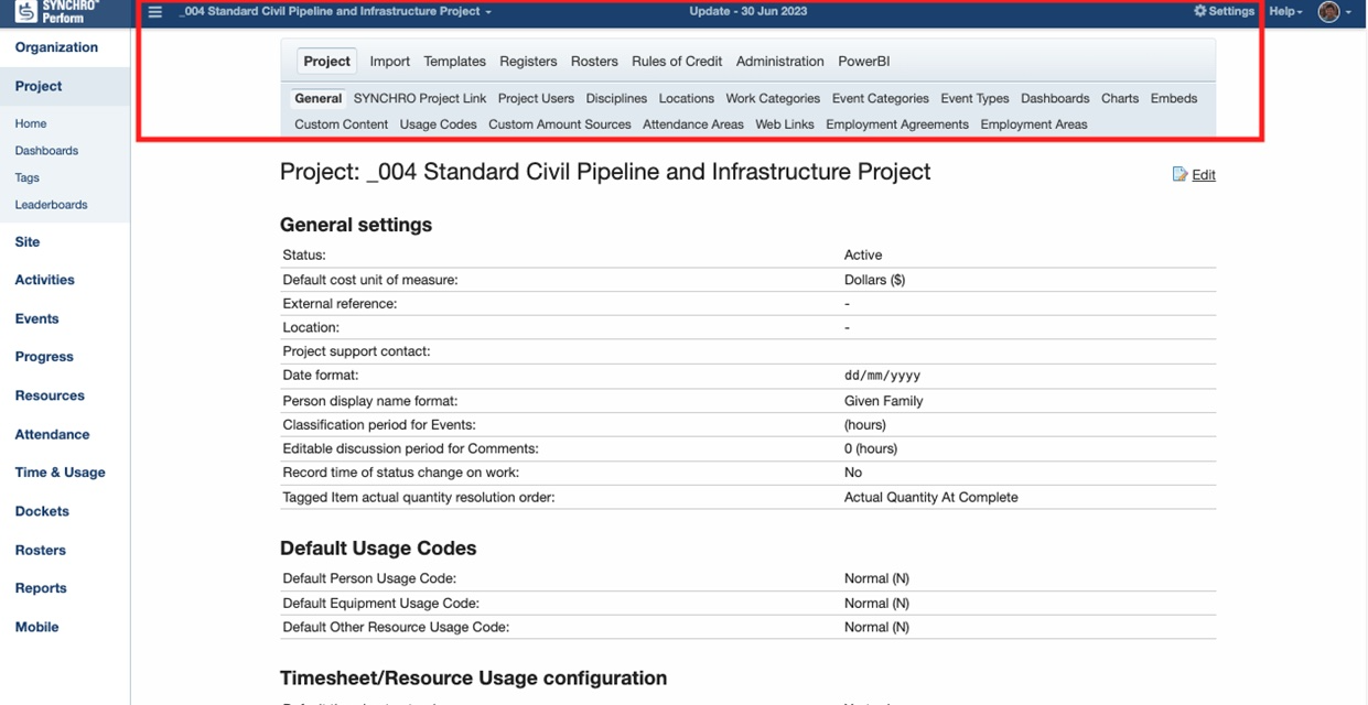

5) From the Home Page, navigate to the Settings (ensuring you have appropriate admin permissions within Perform and Control)
6) Under Settings > SYNCHRO Project Link > Link your SYNCHRO Project
7) You should see your project from a list available within SYNCHRO Control. Select it and press "Link"

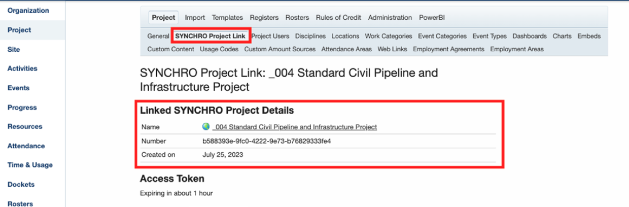

8) Validate that the project is linked correctly, by following the link next to the Globe Icon.
