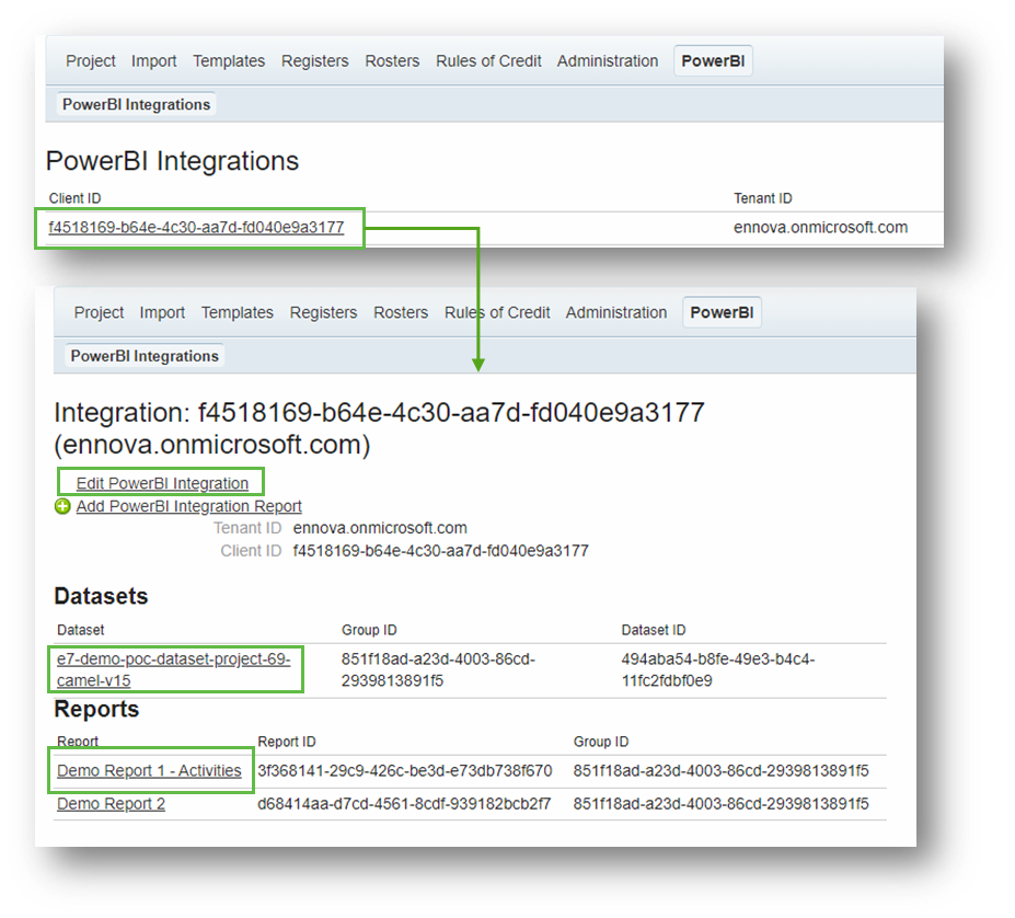

The application will need to be added to any Power BI workspaces that you want to embed in SYNCHRO Perform. This is a once-off configuration for each client project. (the same credentials may be used for multiple projects; however, users should refer to their IT department for clarification)
Go to Settings > PowerBI > PowerBI Integrations
Select Add PowerBI Integrations
Enter the Tenant, Client ID and Client secret details obtained from the Microsoft Azure configuration
Select Create Integration
To edit the integration parameters, refer to Authorise SYNCHRO Perform in Azure for details
* Notes:
View the integration that has been setup - these are the external entities from Power BI
Select the link in Client ID
The Dataset shows a list of connected SYNCHRO Perform datasets (there may be multiple). The Group ID refers to the workspace
Select a Dataset link to edit – refer to Power BI Integration Reports - Add and Edit
The Reports shows each report embedded from the dataset (refer PowerBI)
Select a Report link to edit – refer Custom Content - Edit and View
Select Edit PowerBI Integration to amend the integration parameters, refer to Authorise SYNCHRO Perform in Azure
To add a new Report from the catalogue set above
Select Add PowerBI Integration Report , refer to Power BI Integration Reports - Add and Edit
