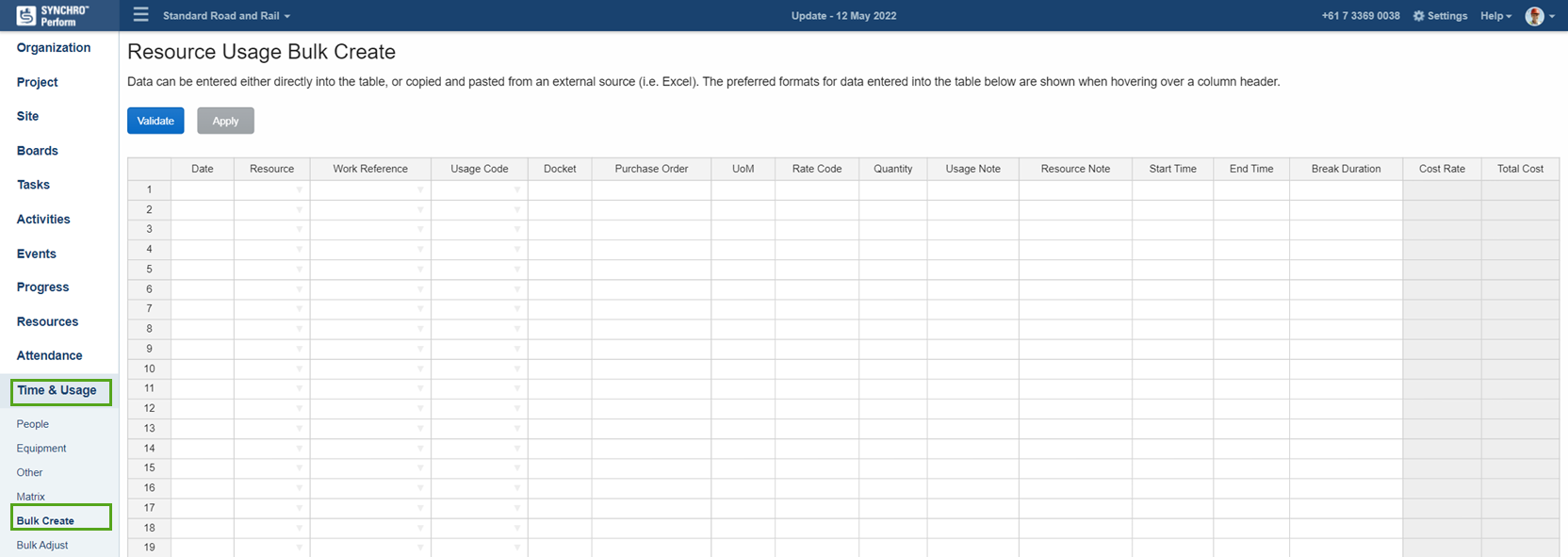

Option 1 - Bulk Create

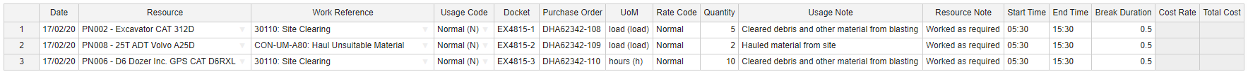

Cost and Production usage for a resource can both be recorded via SYNCHRO Perform's Bulk Create function. Similar to a spreadsheet, data can also be edited in an Excel file before being copied and pasted into SYNCHRO Perform.
In SYNCHRO Perform, click on Time & Usage > Bulk Create
  • Enter information into every field you have information for (click on the image below to expand):
  • When all information has been entered, click on Validate, then Apply.
  • This information will now be available for review, approval and rejection in the People, Equipment, and Other sections of the Time & Usage function
