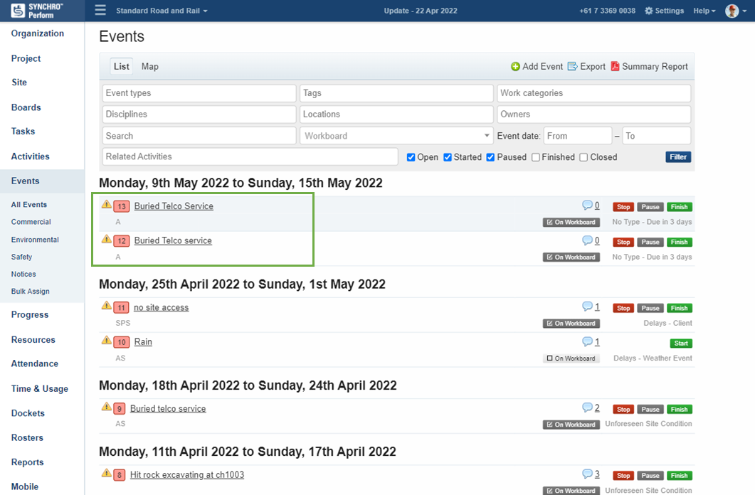

Sometimes, an Event will be entered multiple times in SYNCHRO Perform:

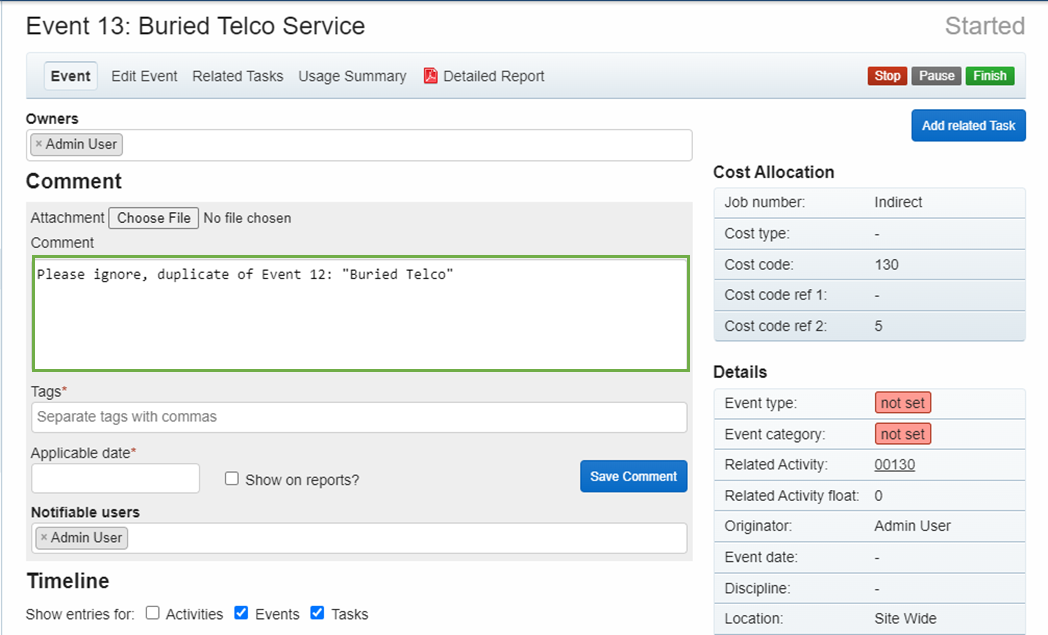

Events cannot be deleted, so if an Event is mistakenly duplicated, click on the duplicate, then add a Comment identifying which is the original Event (including its unique Event number):

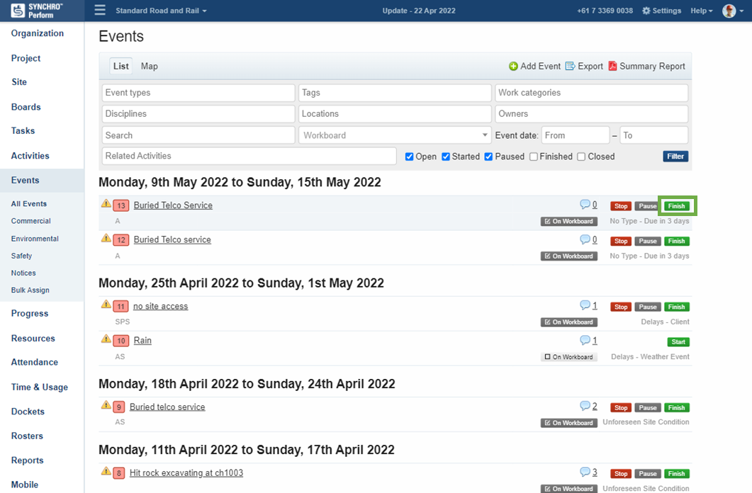

Ensure all information is listed on the original Event, then click on 'Finish' and then 'Close' on the duplicate Event.
