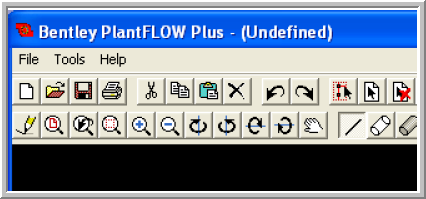

Start the PlantFLOW application
Step 1: Select the PlantFLOW program icon from:
Start> Program> PlantFLOW> PlantFLOW 3.0 for Windows

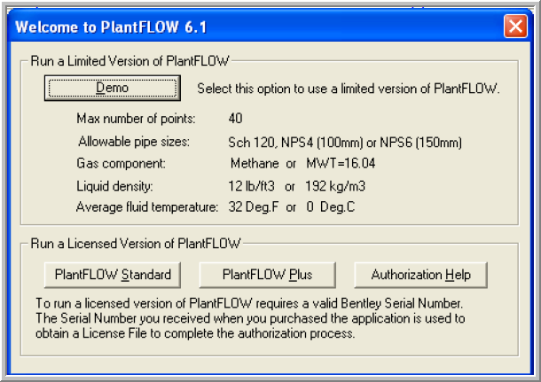

Step 2: The Welcome to PlantFLOW screen will appear.
Step 3: Select the version button listed on your contract:
PlantFLOW Standard or PlantFLOW Plus
Step 4: If licensing was correctly installed, the application is now checking thru the gateway for an available license to check out from the License Management Tool. If a valid license has been located, the “Welcome to PlantFLOW 6.1” screen disappears and the application is ready for use. Verify by inspecting the top of the application bar. The specified licensed version name should appear in the applications bar at the top of the application window.

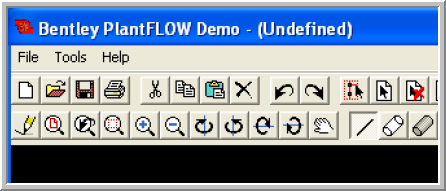

Otherwise a failed license would result in the following
 Trouble shooting
if the program reverts to DEMO mode, confirm licensing settings (especially pointer file names and location)
