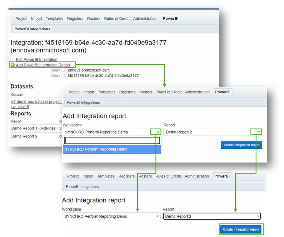

To enable the custom Power BI report to be published and visualised within SYNCHRO Perform, each report needs to be added
Add Integration Reports
Go to Settings > PowerBI > PowerBI Integrations
Select
Add PowerBI Integration Report
Select the dropdown arrow in the Workspace field to select the required workspace
Select the dropdown arrow in the Report field to select the required report
Click Create Integration report
Repeat to add further reports
Notes:
- The Workspace refers to the Workspace within the client PowerBI environment
- The Reports refers to the reports available within the client Workspace

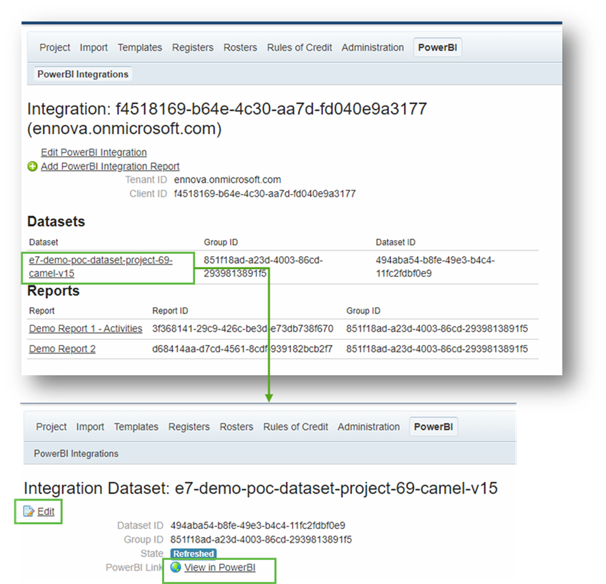

Edit Integration Report
- To edit a PowerBI Integration Dataset, click on the dataset link
- Click on
Edit to attach SYNCHRO Perform data clips to the refresh cycle refer above. - State confirms the refresh status of the dataset
- Click on
View in PowerBI to view the dataset in PowerBI (this will require PowerBI login credentials in the client workspace)
Note: Multiple reports can point to the same dataset
Edit Associated Datasets
- Click on
Edit to add SYNCHRO Perform dataclips to the refresh cycle - Click in the Required Dataclips field to search for and select one or more dataclips
- Once all required dataclips have been selected, click Update Integration dataset
Notes:
- These are the dataclips used in the client report(s) that need to be refreshed when you select Refresh in Analytics page
- Datasets point to dataclips
- Customer datasets can point to dataclips and client data sources
