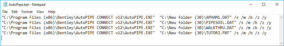

A batch file is a collection, or list, of commands that are processed in sequence often without requiring user input or intervention. In Windows, a batch file has the extension *.bat. An AutoPIPE batch file would start the AutoPIPE program, open a specific AutoPIPE model, perform some simple operations, closes the file, and continues processing the next model until the last line of the script was completed. Example of an actual AutoPIPE batch File needed to perform these operations:

Saving an AutoPIPE Batch file (*.BAT)
After opening the AutoPIPE Batch Generator and creating a script to be run, one can save all the settings to a batch file by pressing "Generate Batch File"   button. This will create a batch file and will be automatically opened in Notepad, where the user can then save save the batch file with a specific name to any folder for future use.
Opening, Editing, and Running an existing Batch file (*.BAT)
By design, the Batch generator will not be able to open, edit, or run an existing Batch file. All of these operations can be performed as one would normally do with any existing windows batch files (*.BAT). Suggest searching the internet for specific instructions or videos.
