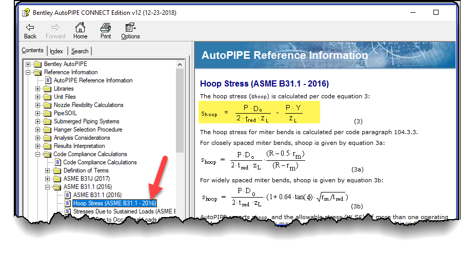

08. How does AutoPIPE calculate ASME B31.1 Hoop stress?
Product(s):AutoPIPE
Version(s):ALL;
Area:
Date Logged
& Current Version
May 2019
12.01.00.09
Please see the following AutoPIPE help section:
Help ribbon> Contents button> Contents Tab> Reference Information> Code Compliance Calculations> ASME B31.1
As mentioned in AutoPIPE help the hoop equation is derived from Code Equation (3), seen below.
The hoop
