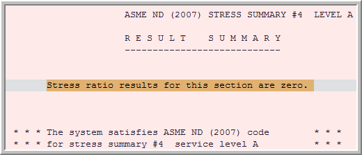

The following Error is shown in AutoPIPE's Results Summary of the Stress Summary sub-report: "Stress ratio results for this section are zero." why?
There is a known issue in AutoPIPE V8i 09.4.xx.xx if User combination names are used exclusively in the Stress Summary that no results are printed, concluding 0.00 stress results with 0.00 values of Stress ratio. Thus the message "Stress ratio results for this section are zero" is printed in the sub-report.

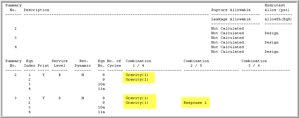

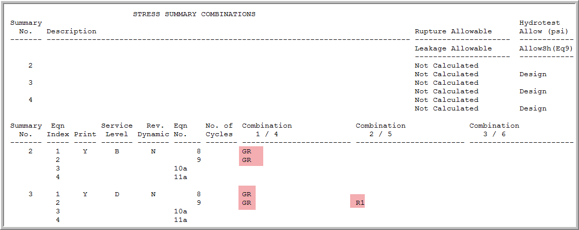

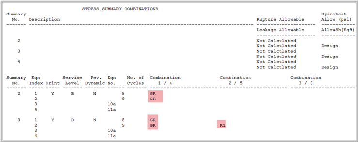

Original Stress Summary: GR and R1 were found to be User Load Case names

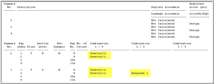

Revised Stress Summary to use Default Load Case names as seen below:

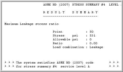

Now the Results Summary of Stress Summary sub-report will be correctly printed:
Stress Summary" sub-report
