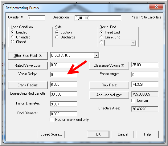

Item #12:
In the online help, Valve Delay, but there is no way to enter this value in Puls dialog.
Answer:
The Valve delay option is on the Recip Pump dialog (see below). However it is only available for systems with Liquid contents and NOT gas contents.
