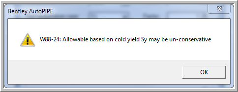

"W88-24: Allowable based on cold yield Sy may be un-conservative" Bentley AutoPIPE message is displa
Product(s):AutoPIPE
Version(s):All
Area: Message
Date Logged
& Current Version
Aug. 2015
09.06.02.06
After selecting any option from the Test Temperature Case on the Hydrotest Drop down listing, the following warning is displayed:
OK
Why and How to avoid it?
Please open Hydrotest load dialog:
Press the Help button and select the hyperlink for "Temperature load case/ Factor" . Details of this message are mentioned there.
Essentially the user should evaluate the Temperature load case selected to be sure if the calculated results are to be conservative or un-conservative.
