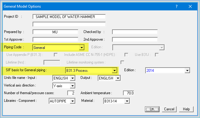

AutoPIPE can calculate the maximum shear stress intensity (instead of Von-Mises) which is Max Tresca stress divided by factor = 2 (also known as Alternating Stress Intensity) and represented by "Total Stress" in the General stress report or General piping code (calculated at every 15deg around the circumference of the pipe from zero location)
1. On General Model Options dialog, set the "Piping Code" = General and "SIF bases for General piping" = B31.3:

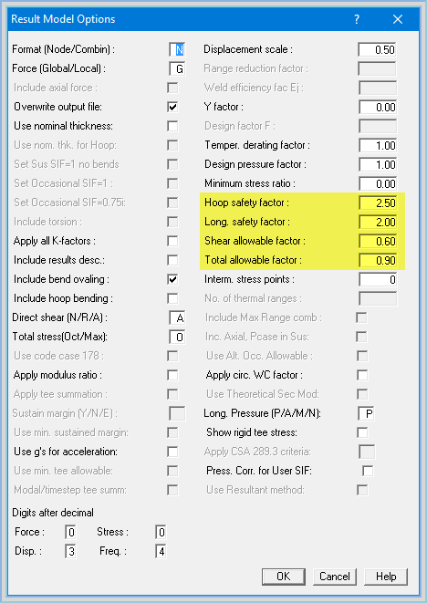

This provides allowable stresses (established by yield stress) to be calculated based on design factors (shown below) as applicable whereas no allowable stresses are available for General stress report
Total allowable factor
Hoop safety factor
Long. safety factor
Shear safety factor

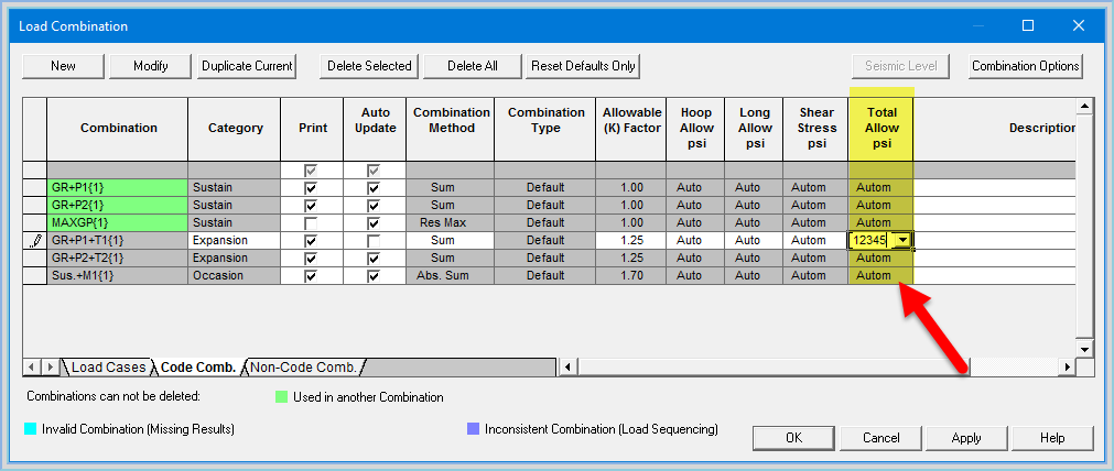

For Fatigue analysis concerns, Total stress (i.e maximum shear stress intensity) are the most import values in the reported results.
With AutoPIPE, option to set User defined allowable stresses on the Code Comb tab of the Load Combinations dialog. Accomplished by disabling Auto Update check box for any load case and changing Total Allow stress for respective load cases from Automatic to "user value" (ex. 12345).

1. Since maximum shear stress intensity = Max Tresca stress/2, the calculated allowable Peak stress should be multiplied by 0.5.
2. Set "Total Stress(Oct/Max) = M, on Results Model Options dialog
3. Define appropriate load combinations e.g.static GR, GR+P1+T1, GR+P1+T1+E1 or dynamic cases M1, R1, H1 etc
