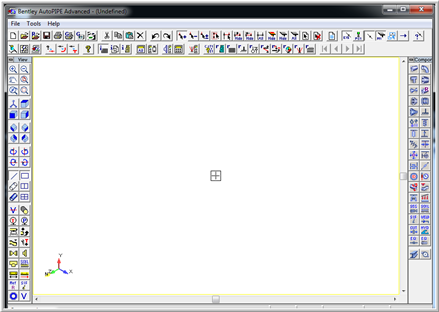

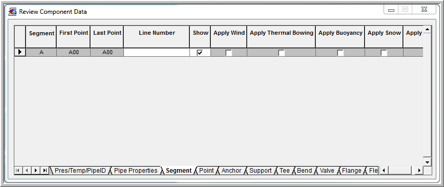

2. The following windows will no appear on screen: a. AutoPIPE application window, b. Input Grids window, c. Welcome To AutoPIPE License window and d. Bentley AutoPIPE News feed window:

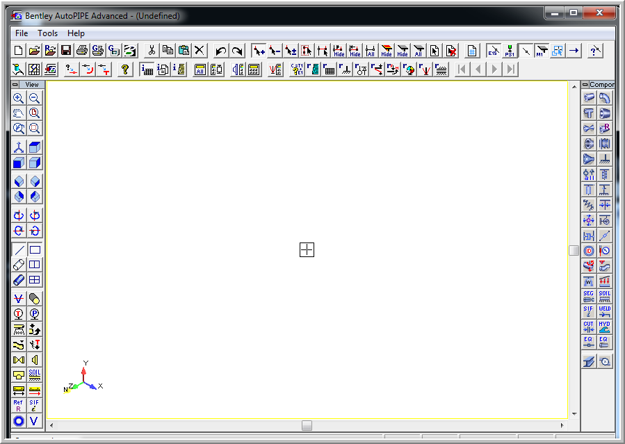

a. AutoPIPE application window:
b. input grids window:

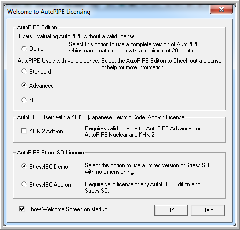

c. Welcome to AutoPIPE Licensing (default setting):

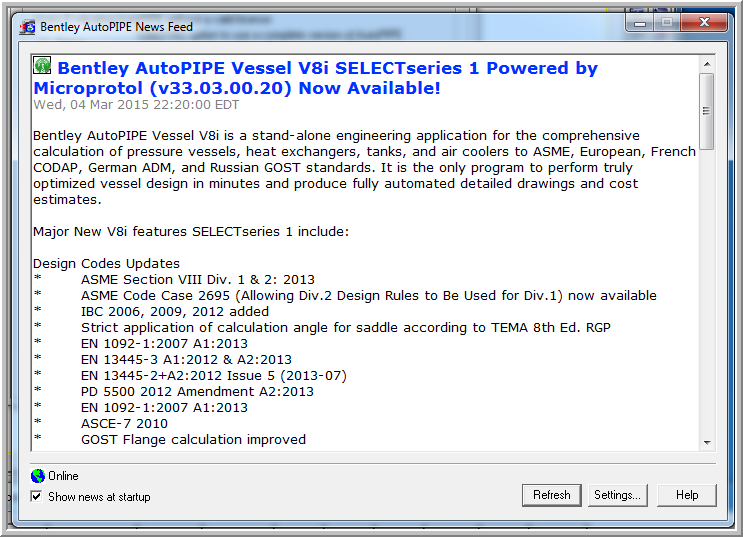

d. Bentley AutoPIPE News feed (default setting):
3. On the Bentley AutoPIPE News Feed, recommend pressing Settings button, then place a check mark for Bentley AutoPIPE & Bentley Releases.

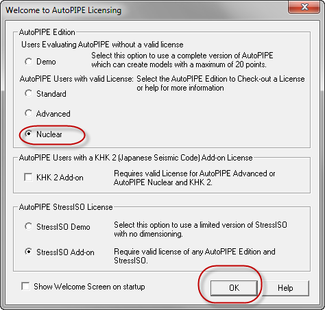

4. On the Welcome to AutoPIPE Licensing screen, press the radio button in front of the type of AutoPIPE version to be used (i.e  Standard, Advanced, or Nuclear) Only select those versions available to you as displayed in the License Management tool. and press OK button.

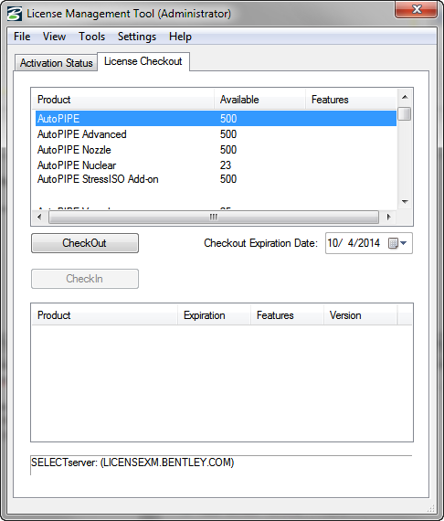

B> After the program opens, ignore the information on the Activation Status tab and select the 2nd tab License Checkout, Is AutoPIPE available in the listing? Are there more than "0" license Available, as sown below?:
If not, with in this application first check Tools> Options>  confirm your Server Name, Site Activation Key, press Test Connection button. A message should appear "SELECTserver and Activation Key verified.". If Not, contact your Bentley On site Admin, or the Bentley License Department. Some one needs to check your server for connectivity, user application restrictions, or missing software.
C> After this has been fixed, back in AutoPIPE, select Tools> Settings> Edition> select one radio button in front of version of the program listed in your LMT that has more than 0 available: AutoPIPE Standard, AutoPIPE PLUS, or AutoPIPE Nuclear.
 Note: If your license contract has the add features, KHK2 or Stress ISO, and wish to add that feature, you can also select those radio buttons in addition to the AutoPIPE version radio button.

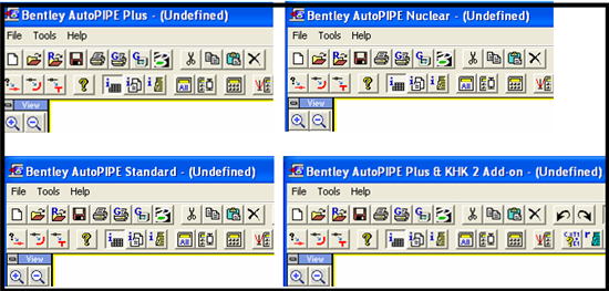

After pressing OK button, the application will look at your License Management Tool, check available license for the product selected, if available, check out the license, reducing the available pool licenses by 1, and the application will be ready for you to use. To verify the application has a valid license, the top application bar will have one of the following:

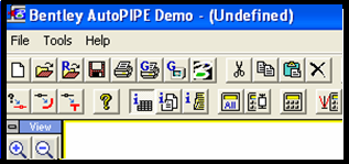

HOWEVER, if a valid license was not found available, the application will revert to DEMO mode, as indicated by:
If revert to demo,

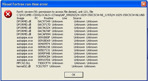

3. Visual Fortan run-time error; forrtl: sever (9) permission to access file denied
During installation or while using the application the following error appears:
The problem with reading/writing this file can be caused by
a. User having no access to this folder (folder is read only)
b. File is read only, check file properties
c. No disk space on drive C: where temp folder is located
d. Change settings in the antivirus to exclude AutoPIPE and also .UND files.
