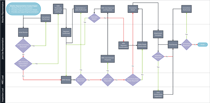

The purpose of the Pole Attachment Request – MRE Provided workflow is to facilitate the attachment request process from the initial submittal, through make-ready construction (MRC), post-construction inspection, and final approval.
This workflow accounts for make-ready engineering (MRE) being completed by the requesting attacher and reviewed by the pole owner. If the attacher is not providing MRE, please reference the Pole Attachment Request workflow.
