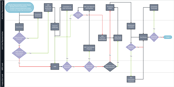

The purpose of the Pole Attachment Request workflow is to facilitate the attachment request process from the initial submittal, through make-ready construction (MRC), post-construction inspection, and final approval.
This workflow accounts for make-ready engineering (MRE) being performed by the pole owner. If the attacher is providing MRE, please reference the Pole Attachment Request – MRE Provided workflow.

Initial Review – Pole Owner
Projects that have been submitted by the attacher will be assigned to the user(s) in the Joint User Representative user group and will be in the status “Initial Review”.
In this status, the Joint Use Representative will be able to review the proposed route, files uploaded by the Attacher Representative, and proposed attachment details. To view the Proposed Attachment Details, navigate to Table View and select Station Rows, then click the Select Columns button at the top of the table. Check the box next to the “Proposed Attachment Details” form, and choose “Display Required Fields and Additional Selections” at the bottom of the dialog box. When review is complete, you may wish to return your Select Columns settings to “Only Display Required Forms”.
Before advancing the project status, the Joint Use Representative must complete the required field in the “Project Form”. To do so, open the Forms section in Detail View, then select the form. Click Edit and select the number of days for the MRE Estimate to be completed; the remaining fields will be completed later in the process. When the project is advanced, a time marker will be added to the project based on the number of days selected.

From “MRE”, projects may be advanced to any of the following statuses:

MRC – Pole Owner
Projects advanced to this status are assigned to the Joint Use Representative. This status is chosen when MRC is not managed directly by the current department or is handled outside of SPIDAstudio.
When MRC is complete, advance the project status to “Proceed to Attach” to notify the Attacher Representative that they may proceed with attaching.

Proceed to Attach – Attacher

Final Review – Pole Owner
The Joint Use Representative user group is assigned to perform any required tasks prior to project closure. From here, projects can be advanced to any of the following:

Send to Finish – Pole Owner
Advancing to this status pushes any available SPIDAcalc data to SPIDAstudio. Ensure that the only exchange file in the Files section contains the data you wish to push to SPIDAstudio.
Advance the project to “Send to Finish” to close it out. A notification will be sent to the Attacher Representative that the project has been completed.
