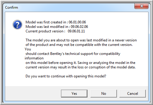

When opening a model created by a newer version of AutoPIPE (ex. 09.06.02.06) in an older version of AutoPIPE (ex. 09.06.01.05) the following will appear:
Confirm
Model was first created in : 06.01.00.06
Model was last modified in : 09.06.02.06
Current product version : 09.06.01.11
The model you are about to open was last modified in a newer version
of the product and may not be compatible with the current version. You
should contact Bentley's technical support for compatibility information
on this model before opening it. Saving or analyzing the model in the
current version may result in the loss or corruption of the model data.
Do you want to continue with opening this model?
Yes No Cancel
What should be done?
There are many suggestions and recommendations about using AutoPIPE but none are as important as this issue and the button pressed next on the dialog:
Selecting “Yes” button WILL corrupt the model the very moment the model is displayed on the screen. There is no fixing a corrupted model.
Selecting “No” button will close the model without opening (Highly suggested)
Note: only exception is that opening a model from a version that has the exact same first 4 digits in the version number (ex. opening a model from 09.06.01.11 in version 09.06.01.10)

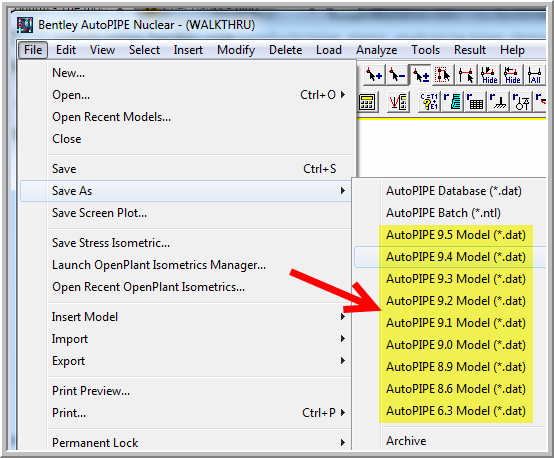

Strongly recommend when this dialog appears to press "No" or "Cancel", reopen the model in the version of AutoPIPE referenced on the dialog as the "Newer Version" (ex. 09.06.02.06). With the model open use the following Commands: File> Save As> select the version of the application with which to open the model in:
The application will ask to save the file name with selected version appended to the end of the name (ex. Walkthru_V94.DAT).
Again, only If both version of the application have the exact same Major and Minor enhancement release numbers (ex. 09.06), only then should one consider pressing the OK button with out worrying about any adverse affects of opening a model created by a new version in an older version with out using the File > Save As process above
