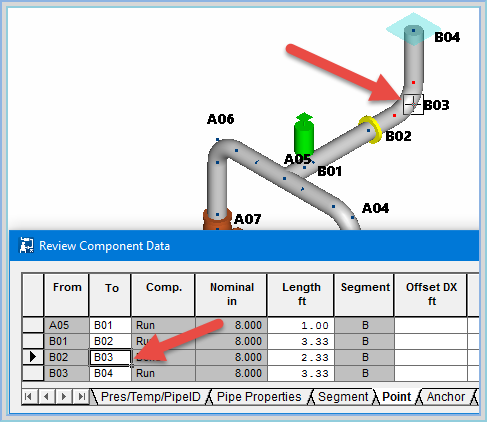

NOTE: All Grids are dynamically synchronized bi-directionally with the graphic plot. Select a cell or group of cells and make a change - immediately see the change on the plot and vice versa. If click on a component on the plot this will place the arrow cursor on the row in the current grid.
Example: Select model node point B03, notice if  there is information on that current grid tab for that node point, the application will automatically snap to that location

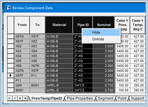

Like Excel select columns then right click to hide or unhide them
HINT: This is very useful to find mistakes in the data e.g. incorrect support type, friction or gaps.

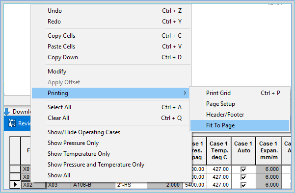

Printing any grid to one page, other options to customize the header and footer with model and company information, right click anywhere in the grids, select Print....

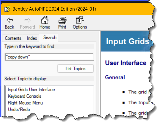

Note: Right Mouse click has a number of commands that should be explored, ex. Copy Down, Show ..., etc.
Refer to AutoPIPE help section for details on these commands:
Help > Contents> Search Tab> enter "copy down" (include the quotes), press List Topics button, double click on the selected topic from the list provided to see more information.

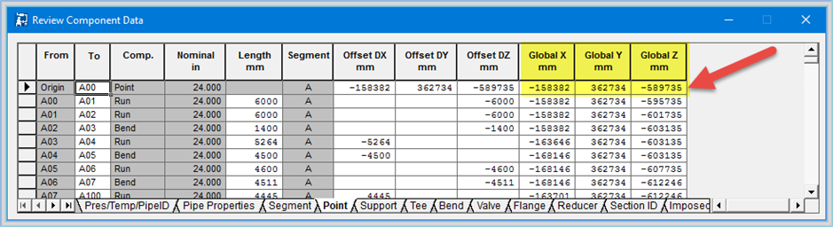

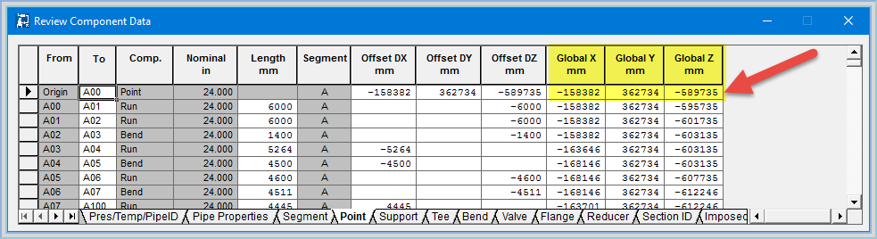

Setting the Global Coordinates for Start of the Model
Option A
  1. In the point grid, go to first entry.
  2. Enter the offsets or global coordinates of the first point in the model.

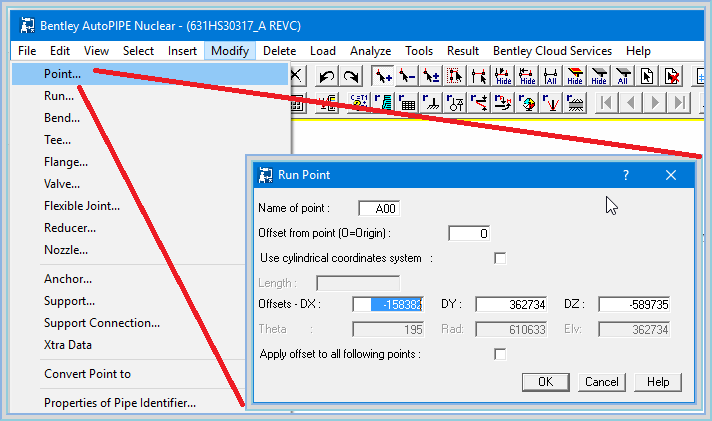

Option B
  1. Select Modify > Point at the first point in the model.
Enter starting offsets from the Origin (0,0,0).

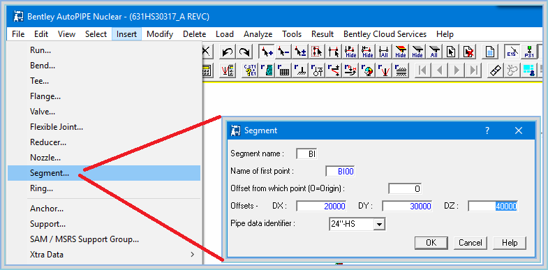

Similarly for disconnected or independent piping systems (segments) set the starting coordinates. Note: A new segment can inserted (Insert >Segment) and enter the Offset point e.g. B10 (not O for origin) and corresponding offsets. So the new segment will be inserted offset from a known point instead of the origin (O).
