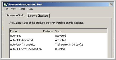

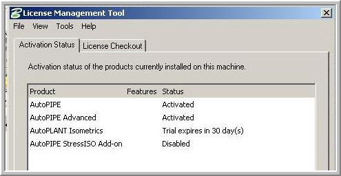

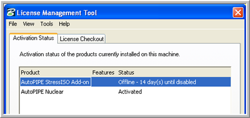

How can I use AutoPIPE Stress ISO, as it reverts to demo mode after June 24, 2014 and the following is shown in License Management Tool (LMT)?
Status = Offline- day(s) until disabled
Status = Disabled

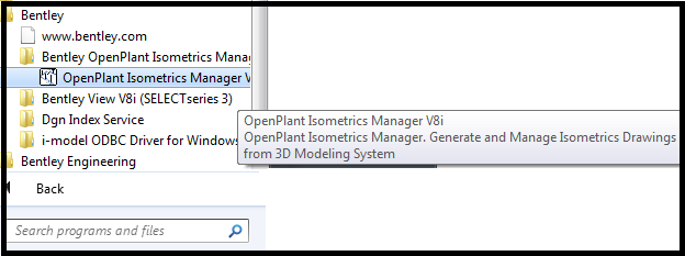

To avoid the potential of being charged for overusage of OpenPLANT Isometrics Manager, DO NOT open / run the Bentley.Isometrics.App.exe file as shown below:
(installed by default in the C:\Program Files (x86)\Bentley\OpenPlantIsometricsManager V8i\OpenPlantIsometricsManager directory).

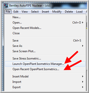

Instead, run OpenPlant Isometrics from within AutoPIPE by selecting File > Launch OpenPlant Isometrics Manager, shown below:

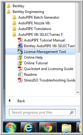

1. Select Start> All Programs> Bentley Engineering> AutoPIPE V8i > License Management Tool (LMT)

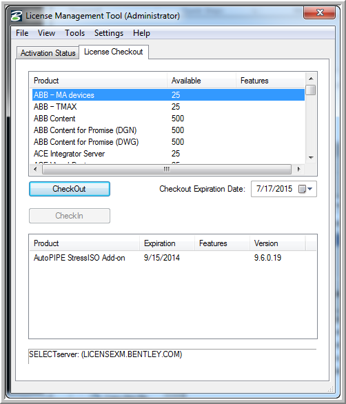

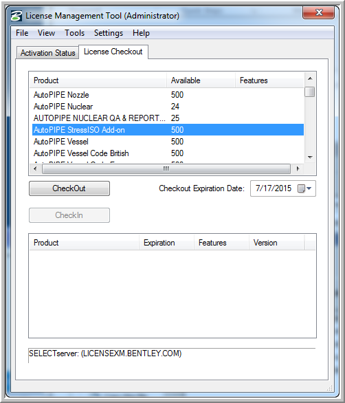

2. After the application opens Select the License CheckOut Tab, scroll down to find AutoPIPE StressISO Add-on (shown below):
Number of Available license must be > 0
If Available Number = 0, Stress Iso will always revert to Demo Mode.
If AutoPIPE Stress Iso Add-on is not shown in the listing, Stress Iso will always revert to Demo Mode.
If Available Number > 0, Manually check out a license:

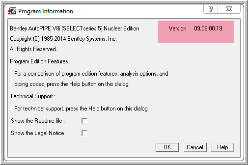

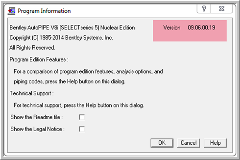

Note: before starting this, Select AutoPIPE> Help> About> write down the 8 digit number on the right side of the dialog and press OK to close:
Back inside of LMT:
a. Highlight AutoPIPE Stress Iso Add-on as shown above.
b. Press the Checkout button.

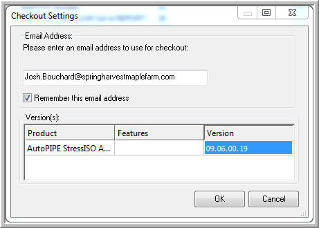

c. Enter the data needed:
i. Enter your Email address
ii. Press keyboard Tab key 5x, enter the AutoPIPE version number in the field provided.
iii. press OK button (note: only after entering all the data above can the OK button be pressed)
iv. In a moment LMT will refresh (or Press F5), and the check out license should appear in the bottom section. At this point LMT can be closed.

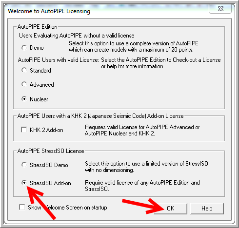

v. Go back to AutoPIPE, select Tools> Settings> Edition> Select Stress ISo Add-on  radio button and press OK button.
vi. If everything was done correctly, AutoPIPE can be used to create a complete Stress Iso.

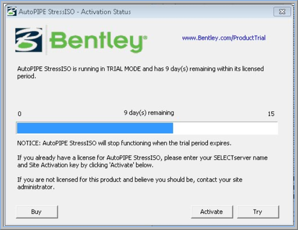

Stress Iso Trial Activation Status
If the following screen appears multiple times and will not go away, set Stress Iso License to DEMO model.
Inside of AutoPIPE, select Tools> Settings> Edition> near the bottom, select radio button in front of "StressISo demo" and press OK button. Restart AutoPIPE.
