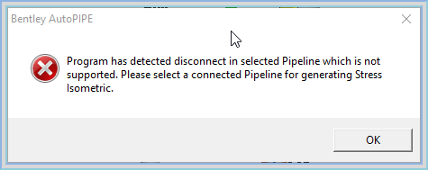

The following is displayed when creating a Stress Isometric
Program has detected disconnect in selected Pipeline which is not supported. Please select a connected Pipeline for generating Stress Isometric.
OK
How to avoid this from happening?
At this time OPIM is not able to produce a stress isometric that has disconnected segments, Typically resulting from multiple systems in one model or from modeling base supported elbows / tees.

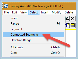

Question: How do I know if there is disconnected segments in my model?
Answer: Easy, in AutoPIPE press on Select> Connected Segments>

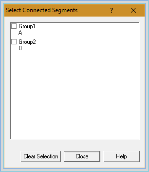

The following will be displayed:
A stress iso can be created from a single connected group, but cannot be created from a model / selection with 2 or more groups. This is a current limitation of the application and will be fixed in a future version of the application.

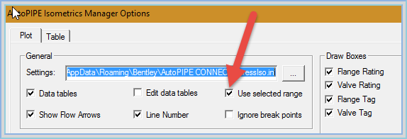

Workaround:
Select only one group of piping from the above command and on the Stress Isometric Manager Options dialog enable the "use selected range" option.
