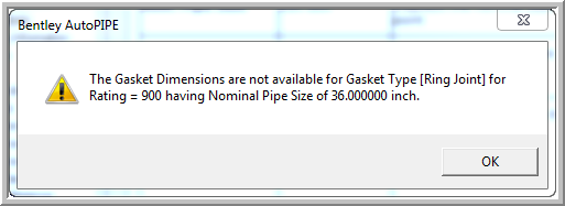

"The Gasket Dimensions are not available for Gasket Type [Ring Joint] for Rating = 900 having Nomina
Product(s): AutoPIPE
Version(s): All
Area: Message
  Date Logged
& Current Version
Mar. 2015
09.06.01.11
The following is displayed when selecting a gasket material on the Gasket type on the ANSI Check tab of the Flange Analysis module in AutoPIPE V8i:
The Gasket Dimensions are not available for Gasket Type [Ring Joint] for Rating = 900 having Nominal Pipe Size of 36.000000 inch.
OK
How to Avoid and resolve the problem?
 The settings provided on the ANSI Check tab of the Flange Analysis module exceeds the values available in the following locations:
a. AutoPIPE V8i 09.05.xx.xx and higher:  "asme2010.mdb" and / or "FlangeDimLib.mdb",
b. AutoPIPE V8i 09.04.xx.xx and lower: Indicated Component library on the General Model Options dialog.

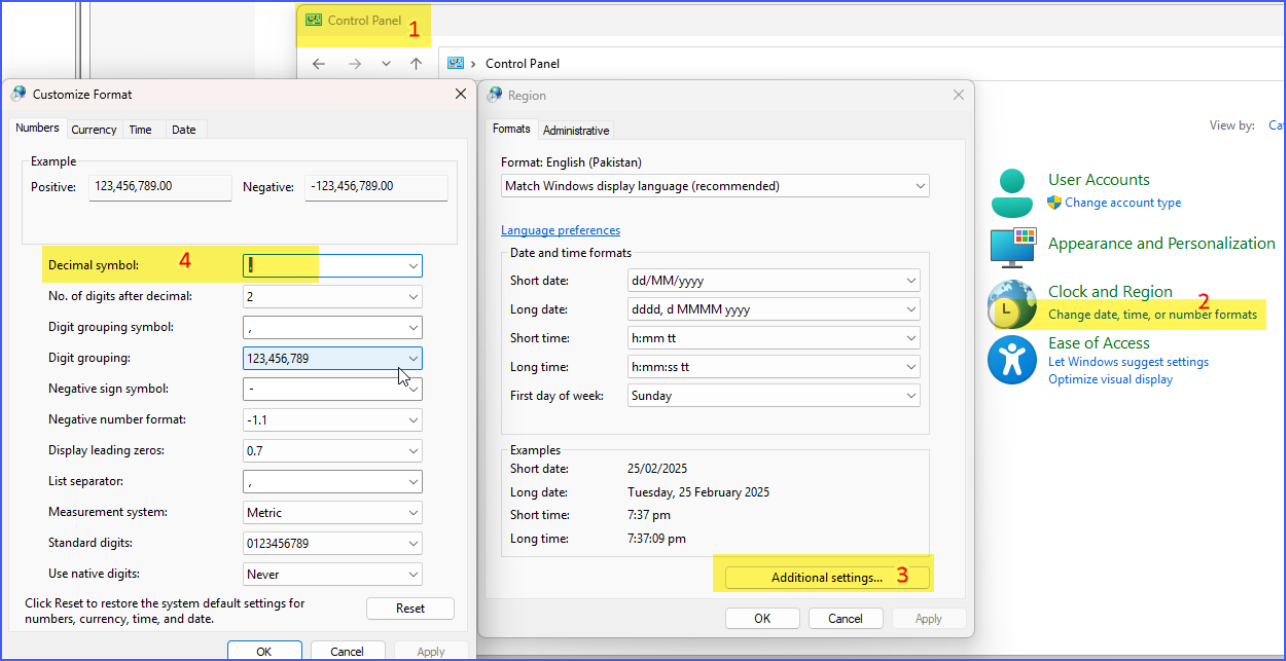

Workaround #3:
Confirm that the Decimal Symbol on your computer is set to period (Dot) and not comma.
Wor
