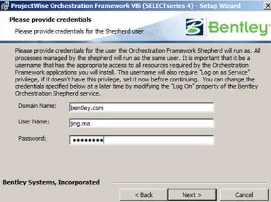

在安装Orchestration Framework后,输入域,用户和密码(如下图)后, 报错 “Credentials failed validation test with error. Message: Logon failure: the user has not been granted the requested logon type at this computer Error code: -2147467259”。
用户没有启动服务的权限

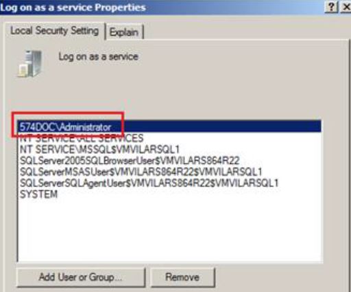

1. 打开Start>Control Panel>Administrative Tools>Local Security Policy
2. 展开Security Settings >Local Policies>User Rights Assignment。
3. 右击Log on as a service,选择Properties。选择Local Security Setting,点击Add User or Group。
4. 输入这个账号点击OK。
5. 点击Apply,OK。关闭对话框。
