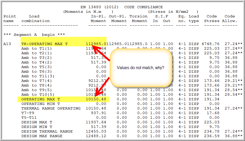

The AutoPIPE code combination value of "Max Range {TR]" does not match the indicated combination value or any of the other Expansion combination values, why?
Example:
This is not correct, there is a problem with the model and it should be reviewed by the CAE development team. Please submit a Bentley Service Request and attach a copy of the AutoPIPE APC file for review.
In addition, please include as much background information as possible about the model (i.e. created using copy clip, created using import, etc..) to help the development team try and reproduce the same results. Only knowing how the problem occurred, can a solution to prevent it from happening be added to the program. Any and all information is appreciated.
Workaround:
With the affected model opened in AutoPIPE V8i (assuming 09.05.xx.xx or higher), preform the following:
1. Select File> Save as> Choose AutoPIPE 9.4 (dat) or any earlier version than currently being used.
2. After the model was saved, close the current model.
3. Select File> Open> locate the file from step #2 above (i.e."filename_v94.dat") and Open it.
4. Save the file to the current edition format, File> Save
5. Review the entire file to determine input values and settings are found to be correct
6. Select Analyze> All.
7. Review the results.
The results should be correct now.
Again, please send any information about your original model for review in the SR.
